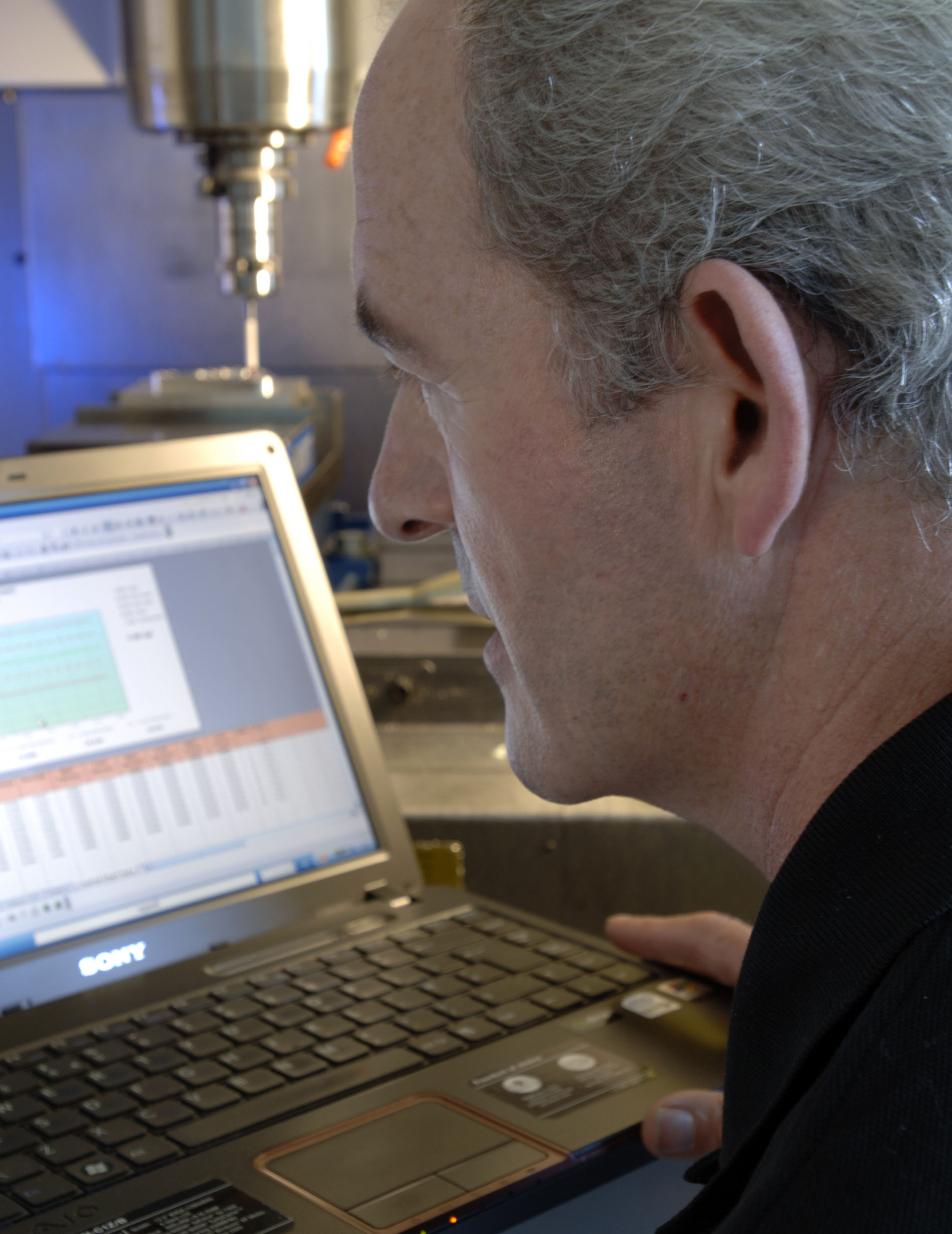

Clada Medical - OMP40 probe measuring features“The touch probe measures the part during the production cycle, the great thing about it being the way the Productivity+ routine updates the tool offset. I know I can get a precision part every time, with the system automatically controlling itself. The measured data is also recorded by CNC Reporter, providing feedback to adjust the process and keep it within control limits. That’s the kind of confidence I need to put some of these new ideas into production.”
“Guy and Frank helped me make a calibration part incorporating most of the features I’d be likely to machine. I know exactly what I have to do and the tools are all set up in the library, so I use it and don’t need to mess around with it or change it. The probing moves are in there to control the process but also to verify the finished parts - if there is any variation that can be fed back to the CNC control. I can also get a print out for the QA people or for my own records.”

    Ray Blowick uses the latest software to program the whole machining process, including the probing moves
  • Clada Medical - Productivity+ and CNC Reporter [2.4MB] Clada Medical - Productivity+ and CNC Reporter
    Ray Blowick uses an integrated package of software to create component designs, machining programs, and, using Renishaw Productivity+™, probing routines. The machining process is fully controlled using Renishaw CNC Reporter to monitor measured data.
