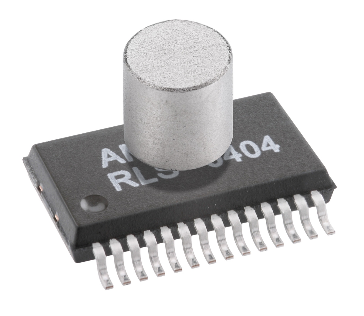

Magnetic encoder chip gives real time position verification
AM256 with magnetRenishaw’s AM256 8-bit encoder chip is a solid state, compact magnetic solution for non contact angular position encoding over 360°, providing incremental, parallel, serial SSI and analog sinusoidal output options. The encoder's integrated circuit senses the angular position of a diametrically polarized, cylindrical magnet placed above it. A circular array of Hall sensors around the center of the IC detects the magnetic flux density distribution at the surface of the silicon and delivers a voltage representation of the magnetic field distribution. Sine and cosine voltage outputs from the Hall sensors vary with magnet position, and are converted to absolute position with a fast 8-bit flash interpolator. Relative changes of angle position are output as incremental A quad B signals with 8-bit/256 counts per revolution.
High reliability in harsh environments
With an operational range of -40°C to 125°C, high resistance to shock and vibration, and rotational speed capability up to 60,000 rpm, the AM256 combines ruggedness and performance needed for harsh environments. Working closely with its associate company RLS d.o.o, Renishaw offers an extensive line of solid-state magnetic encoder chips based on the proven OnAxis™ Hall sensor technology, ranging from the AM256 8-bit to the AM8192B programmable 13-bit chip. Renishaw also custom designs solid state encoder solutions for motor OEMs.
