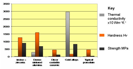

Comparison with other dental materials
Material comparison chart
Although not as hard as densely sintered alumina, zirconia has much greater flexural strength, making it suited for posterior crowns and multi-unit bridges.  By comparison, castable ceramics are very weak.
Zirconia's ultra-low thermal conductivity also gives greater patient comfort.
