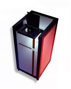

 | RA100 Raman analyserThe Renishaw RA100 is a compact Raman system for process monitoring and bulk material analysis. It enables in situ Raman monitoring in the laboratory, pilot plant, or process line. Features- Rugged components for an extended trouble-free lifetime

AccessoriesRA100 Raman analysers can be equipped with almost all of the accessories of the inVia series of Raman microscopes, and in particular the range of fibre optic probes and temperature, humidity, and pressure cells. Application example RA100 Raman analysers are used in the hard disc industry for the quality control of diamond-like carbon (DLC) protective films. They are used with the DLC analyser station (shown on the right); this allows users to load and analyse hard disc platters close to the production line.
In this case, the Renishaw custom analysis program is pre-configured to analyse several positions on the disk and then output the results in an easy to interpret form (as a table, ratio, or simple 'pass' or 'fail'). These systems have enabled users to improve yield and dramatically cut costs. Tell us what you think about our websitePlease help us improve our website by taking our short website survey. |
