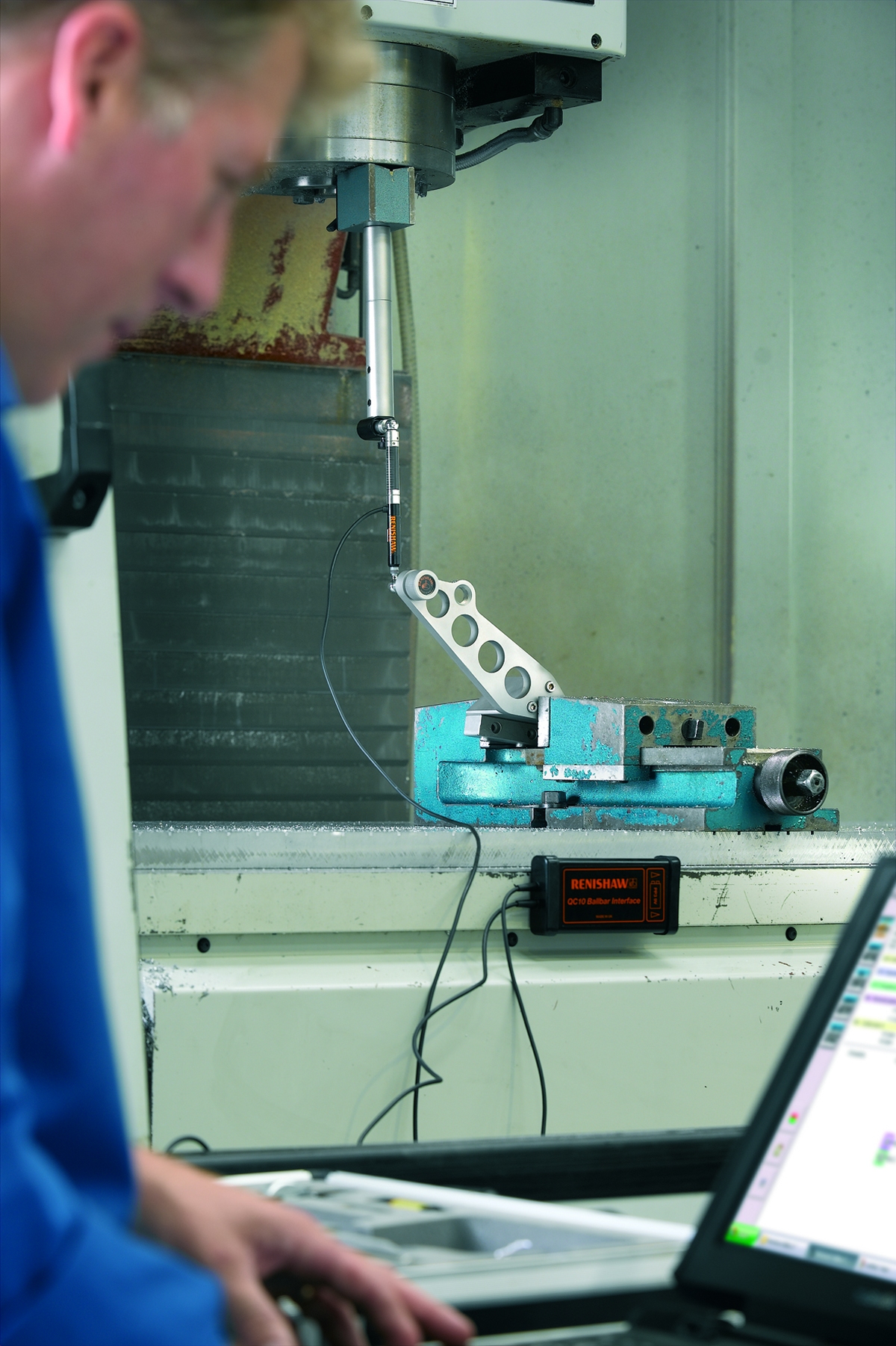

Monitoring machine capability with Renishaw’s QC10 ballbar has proved crucial to TJW, a successful machining sub-contractor who specialise in the pharmaceutical and aerospace industries. TJW regards itself as a ‘one-stop shop’ with a complete range of services. It is able to provide fast change-over between a wide variation of batch sizes and component types, with Renishaw machine tool probe systems minimising set-up times. TJW uses the QC10 ballbar on its CNC machining centres to keep tight process control and meet quality requirements. One of its large contracts relies on being able to prove machine capability, not just produce parts within tolerance. It has a number of HAAS machines, which are checked regularly with the ballbar, by both TJW machine operators and HAAS engineers, who use it as part of the annual service. The HAAS engineers provide ballbar test results as proof of machine accuracy after servicing work is done. TJW, based in Cam, Gloucestershire, first heard of the ballbar through a West of England Aerospace Forum manufacturing initiative, which promotes process improvement and provides funding for training to aerospace and defence SMEs in South West England. Ben Bartholomew, Technical Director, went to see demonstrations of the ballbar in action at Renishaw’s own machine shop, and took the decision to use it in their own shop. "We needed to understand our machines’ capability and control it, rather than waste time tweaking programs on machines we weren’t always certain could do the job. "TJW started out in 1983 doing wire erosion work, then bought a milling machine to do erosion tools and finally started selling its machining service. The company has grown its floor space nine times and now has 13 CNC machines and 15 wire / spark erosion machines. Being able to offer multiple processes and therefore a complete service has been key to their success. QC10 ballbar - quick test of multiple machine variables
Ben Bartholomew explains "Simple adjustments, such as backlash, we do ourselves on the machine control. Otherwise, if we see a problem developing that will involve maintenance, we can look ahead and book it in around jobs before it starts affecting performance, reducing the amount of unplanned maintenance." He continues "The other big advantage is that now we know every machine’s capability. I can plan jobs onto machines which I know can do them, really cutting down the set-up and proving-out that we previously needed to do. The QC10 ballbar enables us to monitor and maintain that capability and, having done the initial benchmarking, we’re now building up a history of our machines with the software’s history function. Machining centres are checked every 2 months in the X-Y plane, where most positioning occurs, and every 6 months in X-Z, as a number of our jobs require accurate interpolation involving the Z-axis. We also test every CNC lathe to control their performance." TJW has one job in particular that demonstrates how the QC10 ballbar has improved confidence in machine positioning; a circular plastic part that is too big for any of their lathes. This is cut on a machining centre using circular interpolation - the corrections made with ballbar data ensure this can be achieved within tolerance. Scrap reduced and productivity increased
