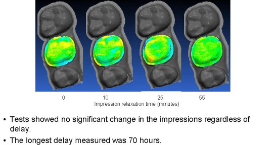

Impression stability
Impressions were taken of a prepared tooth and left to relax for different times before pouring the model.
This test showed that there was no difference between an immediately poured impression or one left to relax.
