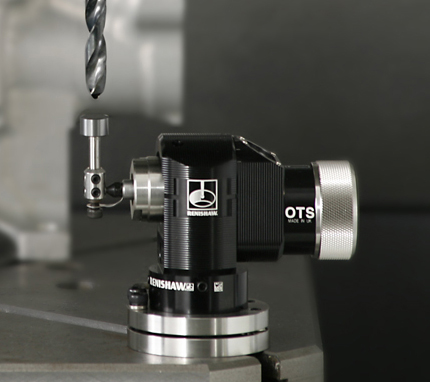

The NEW OTS tool setting probe
OTS on machineRenishaw’s OTS tool setting probe with optical transmission is a robust, compact and cable-free product which provides no restrictions on table movement, and offers users broken tool detection and rapid measurement of tool length and diameter.

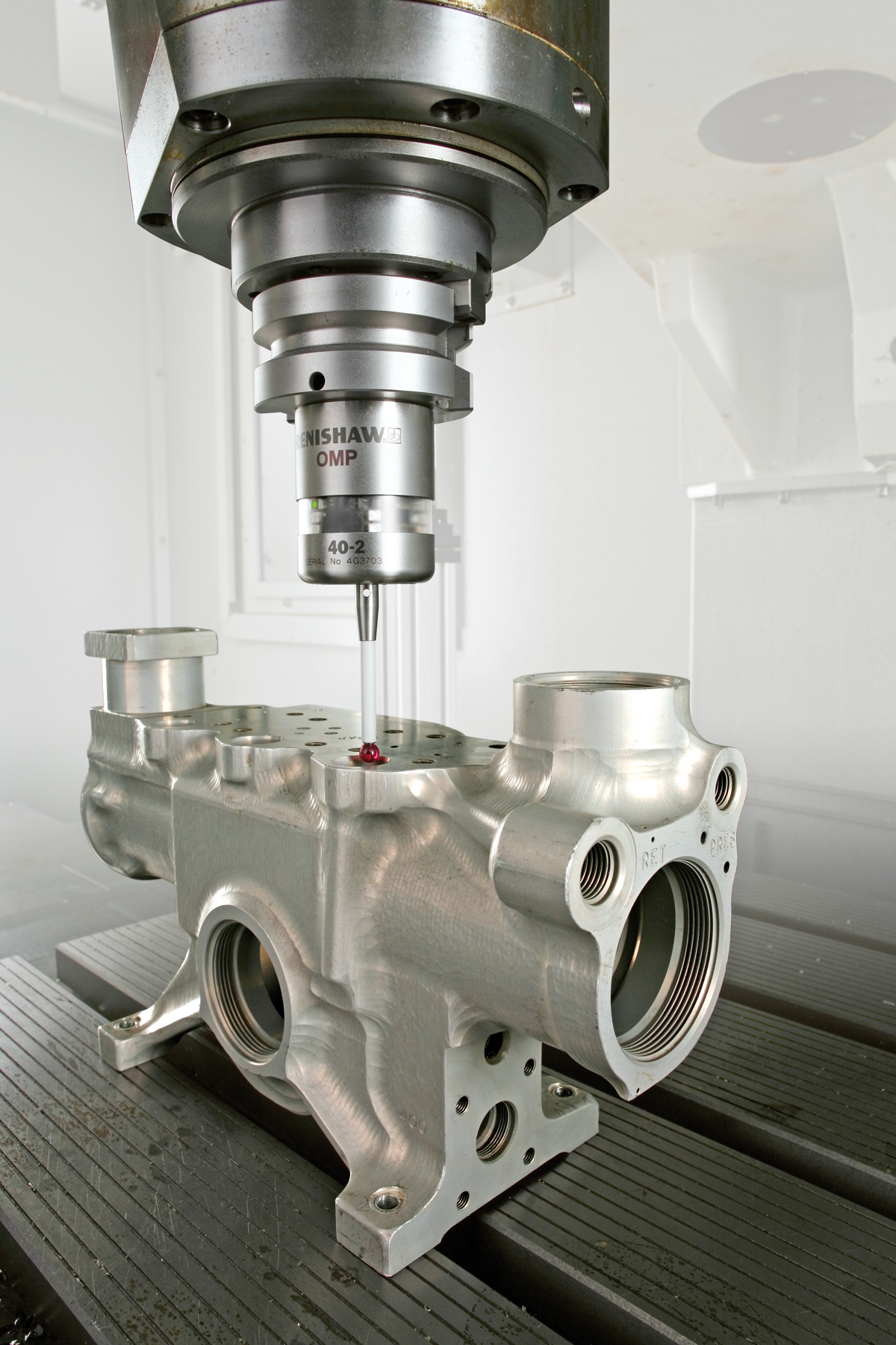

The Renishaw OMP40-2 is an upgrade to the original award-winning OMP40 touch probe. It meets the demand for probing on small machining centres and the growing family of high-speed machines fitted with small HSK and small taper spindles. User programmable parameters make the OMP40-2 simple to optimise for specific machine applications and, using Renishaw’s unique Trigger-Logic™ programming method, allows users to easily program probe options. This avoids the need to access internal probe components, therefore eliminating the risk of subsequent damage due to coolant and debris ingress.
OMP40-2 inspectSealed to withstand harsh machine tool environments and being highly resistant to false triggering induced by shock and vibration, the Renishaw OMP40-2 is fully compatible with existing and future Renishaw optical systems. It can be used with high-speed, single touch or double touch probing routines.
