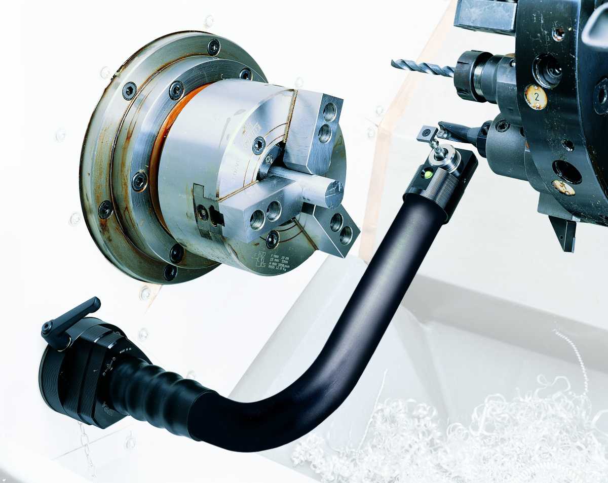

Manufacturing the hubs for each of the models, the first and most important of the machining operations comprises four, twin-spindle CNC lathes, each fitted with Renishaw’s HPRA tool setting arms.  The lathes are dedicated in pairs to each model, and electronic sensors around the highway ensure that the relevant part is conveyed to the assigned machining operation.  However, depending on demand, flexibility exists to utilise any number of the lathes for a particular model.

In relation to the lathe cycle time, a ‘known’ machine operation, the minimum number of tools is backed up by sister tooling stored in the carousel.  A tool management system is in place, that with a known tool life will see an alarm signify the need for a complete tool change after 4 hours of unmanned running.  Having replaced the tools, the Renishaw HPRA tool setting arm is located into a fixed base within the lathe, and a program is called up by the operator to run a mini-sequence using the arm.  This automatically corrects offsets and ensures each tool is in position to start the machining sequence.  This operation is repeated in the second cabin of the twin-spindle lathe.

“The Renishaw HPRA was not part of the initial cell concept and needed to be reviewed.” stated Emmerson.  “We were generating too much scrap using optical presetters to measure our KM units. Also, following this form of measurement, a bank of data of some 150 characters had to be typed into the CNC control by the operator.  One human error could result in crashing a £200K machine tool.  We could have opted for direct feedback from the presetters, but the Renishaw option was more cost-effective.  Today, the repeatability is guaranteed, operator error is minimised, and scrap rates eliminated.”
