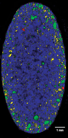

Pharmaceutical tablet
Tablet dissolution behaviour correlated to distribution and concentration of tablet components
Tablet_batch1Tablet from production batch 1
StreamLine™ Plus image showing the distribution of ingredients in a pharmaceutical tablet
Map area: 6 mm x 12 mm
Spectra generated: 82,000
Acquisition time: 38 minutes

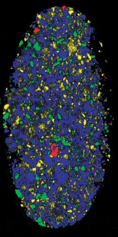

Tablet_batch2Tablet from production batch 2
