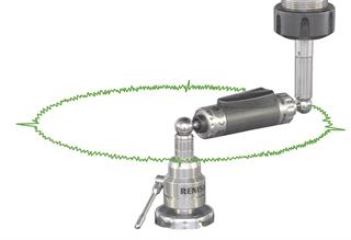

Redesigned ball mounts (including new centre pivot and tool cup extension) allow the QC20-W to carry out additional 220° 'partial arc' tests in planes through the centre pivot axis. This means that you can now carry out ballbar tests in three orthogonal planes without the need to reposition the centre pivot, so speeding up testing (if carrying out 'partial arc' tests with a radius greater than 150 mm custom fixturing is required). The results can also be used in the new 'volumetric analysis' report function (see software section) with the assurance that all data has been gathered around the same point. See a complete QC20-W ballbar test animation here; including the new partial arc feature: Using optional accessories
