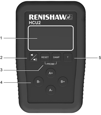

HCU2 labelled
Key
Description
1
LCD display
2
Beep on / off button
3
Probe functions button
4
Direction buttons
5
Transmit button
