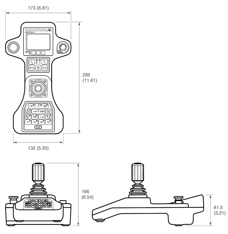

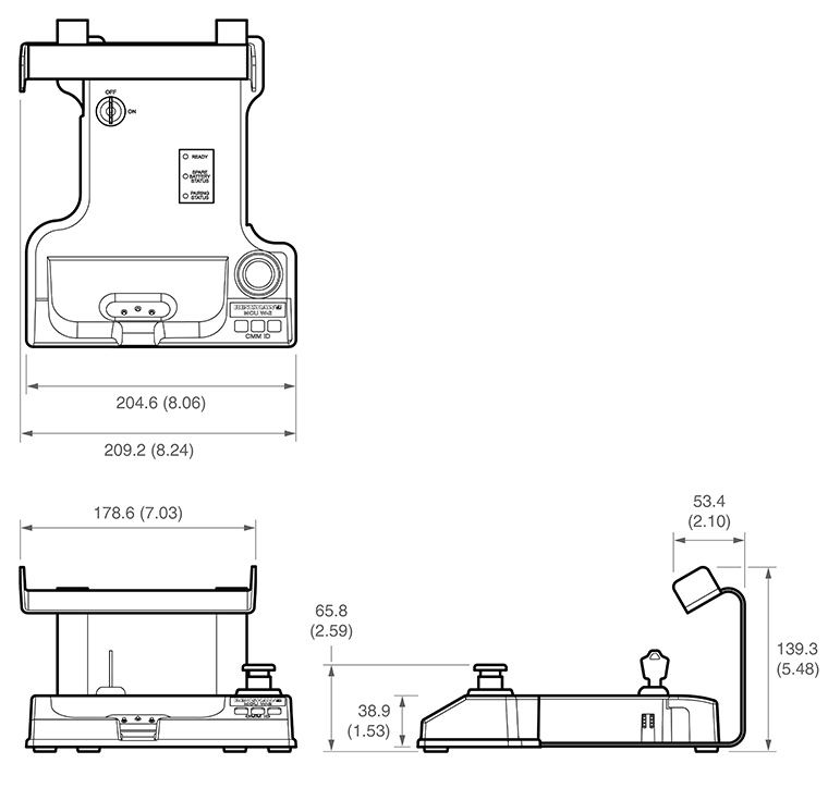

Dimensions
MCU W-3 - dimensions
MCU W-3 cradle - dimensions
NOTE: Dimensions in mm (in).

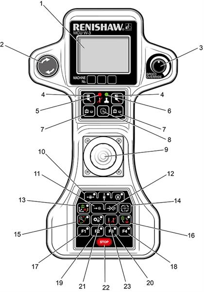

MCU W-3 visual guide
Key
Description
1
LCD screen
2
Stop switch
3
Speed override
4
Joystick enabled head mode (see '6' and '15')
5
Probe disabled LED
6
Joystick enabled LED
7
Joystick control of CMM or rotary table (see ‘6' and '16')
8
Bore teach
9
3-axis joystick with push button
10
Joystick locks (three separate buttons)
11
Take point
12
Cancel point
13
Joystick co-ordinate system (axis select)
14
Joystick orientation
15
Switch between orbital mode and head mode
16
CMM movement or rotary table
17
F1 function
18
F4 function
19
F2 function
20
F3 function
21
Engage servos
22
Stop
23
Probe disabled (see ‘5')
