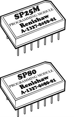

Programming modules
A programming module for each of the following Renishaw standard multiwired products are supplied pre-installed within the IS1-2 channels:
Channel 1
TP7M
Channel 2
SP600M
Channel 3
SP80
Channel 4
SP25M
An OTP6M module will be supplied in the IS1-2 kit.
Plugging the required product module into the correct channel selector socket ensures that the probe connections are made to the correct IS1-2 output port.
