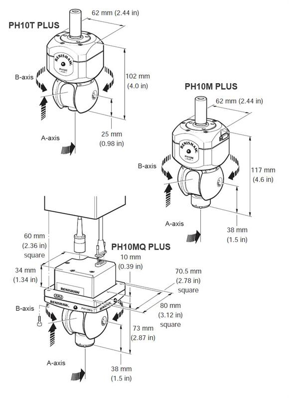

The PH10 PLUS range of motorised heads consists of three different models.
Each head in the PH10 PLUS range is a general purpose, versatile unit designed specifically for use on direct computer controlled (DCC) CMMs and incorporates the following features:
  • 720 indexing positions
  • 0.4 μm indexing repeatability
  • 7.5° indexing steps in both axes
  • 300 mm (maximum) extension bar capability *
* NOTE: 450 mm is possible for PH10M PLUS / PH10MQ PLUS with special order carbon fibre extensions.
WARNING: No attempt should be made to connect the PH10 PLUS system to any other any other system components as incompatibility will result in damage to the product.

Dimensions from quill face
XY (all)
Z (PH10T PLUS)
Z (PH10M PLUS)
Z (PH10MQ PLUS)
62 mm
102 mm
117 mm
73 mm
Weight
PH10T PLUS
PH10M PLUS
PH10MQ PLUS
595 g
620 g
730 g
PH10 PLUS range dimensions
