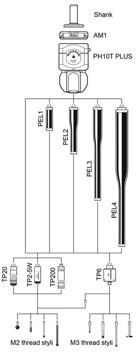

PH10T PLUS probe system diagram
The diagram below shows the range of extensions, probes and styli which can be used in conjunction with the PH10T head.
PH10T PLUS system diagram

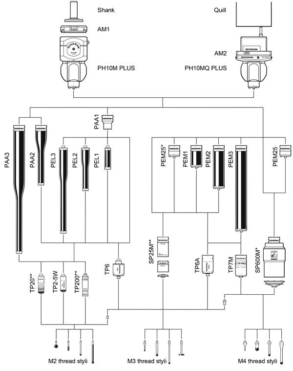

PH10M PLUS and PH10MQ PLUS probe system diagrams
The diagram below shows the range of extensions, probes and styli which can be used in conjunction with the PH10M PLUS and PH10MQ PLUS heads.
PH10M and PH10MQ PLUS system diagram
* PH10MQ PLUS used with SP600M requires a PEM25 extension bar to achieve A = 97.5° or A = 105° in all B-axis positions.
** Other modules versions are available for TP20, TP200 and SP25M.
