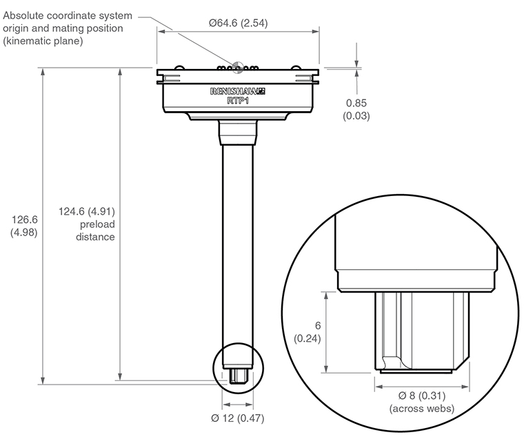

Dimensions
RTP1
RTP1 dimensions
NOTE: Dimensions to kinematic mounting plate.
RCP TC-2
RCP TC-2 - dimensions
NOTE: Dimensions are shown in mm.
