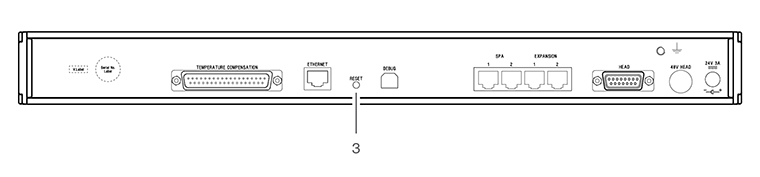

UCC S5 rear panel - labelled - reset button
The rear panel reset button has two different functions. The function depends on the operational state of the controller.
  1. Pressing and releasing the reset button within 15 seconds of switching on the unit will force the controller into IP configuration state.
  2. Pressing and releasing the reset button after 35 seconds of switching on the unit will cause the unit to restart.
To enter IP configuration state when the unit is already running the control software, press and release the reset button twice.
