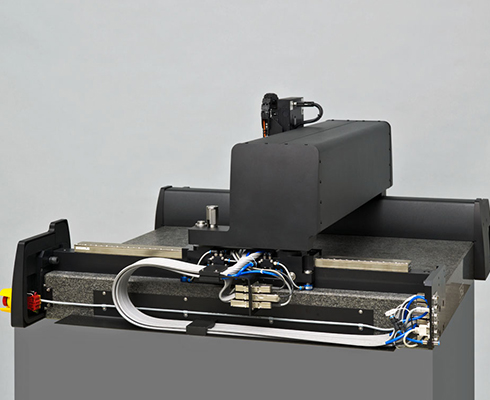

Steinmeyer-FMD's new motion system consists of an XY stage utilising air bearings plus a conventional ball screw driven Z table, with the TONiC optical linear encoder providing incremental position feedback on all the linear axes. The motor concept is based on a wear-and-noise-less drive operating at very high speeds. Depending on the application, the XYZ design can be complemented with A- and B-axes and adapted to the required load, speed and accuracy.
Steinmeyer-FMD’s new air bearing gantry LLP without cover

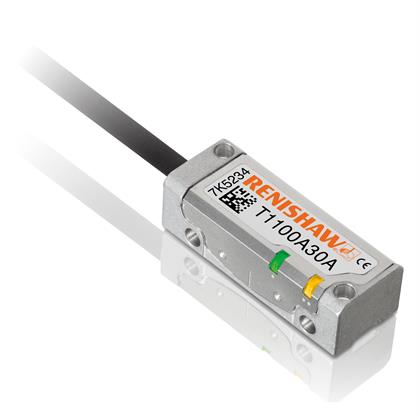

Website cameo: TONiC readhead
Smooth velocity control is achieved as the TONiC encoder incorporates dynamic signal processing within the readhead, providing an ultra-low Sub-Divisional Error (SDE) for improved signal purity. The reduced jitter, of just 0.5 nm RMS, and finer resolution, result in an encoder that provides significantly improved positional stability and excellent low-speed velocity control. Long-term operational reliability is further assured with the TONiC encoder's proven filtering optics, which are now enhanced by Auto Gain Control (AGC) for rugged signals that can withstand dust, scratches and light oils on the scale.
The super-compact TONiC encoder is also available with a variety of high-accuracy linear and rotary scales, and new 1 nm and 2 nm resolution versions have recently been added to the range. TONiC incremental encoders offer all the benefits of a 20 micron pitch encoder, such as easy set-up, low cost of ownership and superior dirt immunity, yet they also rival the resolution and noise levels of much finer pitch encoders.
The new Steinmeyer-FMD stages are considered as ‘custom solutions' and optimised with regard to the required conditions. XY specifications include: travel to 600 mm x 600 mm, positional accuracy to 10 microns, positioning repeatability of ±1 micron, plus straightness and flatness of 1 micron over the full travel range. Both X and Y stages are driven by ironless, electrodynamic linear motors with maximum acceleration of 10 m/s2 and XY velocity of 1000 mm/s. Position feedback from the TONiC incremental encoder has a resolution of 50 nm on the XY stage and a positional accuracy of 10 microns on the Z axis.
