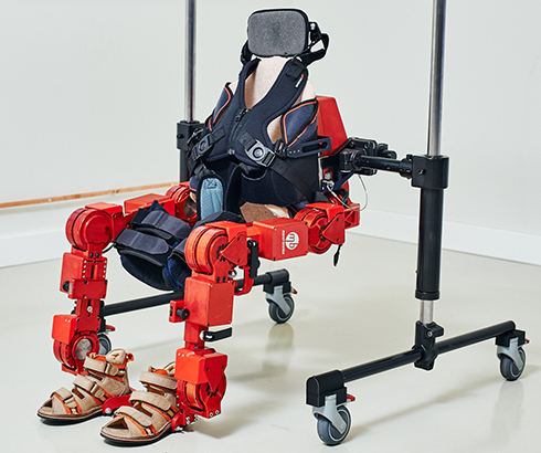

Child wearing ATLAS 2030 exoskeleton in seated positionChild wearing ATLAS 2030 exoskeleton in seated position

The ATLAS 2030 exoskeleton has up to six degrees of freedom per limb. This device enables the user to perform both unaided and self-actuated actions such as walking and sitting. Full exoskeletons consist of motorised joints, limbs, electronic control and power systems.
The designer must find a compromise between a lightweight and compact structure that facilitates easy handling by the user, who might be physically weakened, and a robotic system that implements a physiologically complete biomechanical model.
For stable walking, equilibrium control of the exoskeleton-user assembly is achieved by tracking its zero-moment point (ZMP) references, which are based on the desired Normalized Dynamic Stability Margin (NDSM). The exoskeleton's controller can subsequently adapt reference walking gait patterns, stored in memory, to maintain stability.
Successful dynamic walking requires precise control of the legs' joint angles in terms of position, velocity and acceleration via rotary encoder feedback. This is difficult to achieve as each mechanical joint is compliant and includes elastic elements to help mimic and support the real joints and muscles of the human user.

Marsi Bionics’ ATLAS 2030 exoskeleton for children
Marsi Bionics' ATLAS 2030 exoskeleton for children
