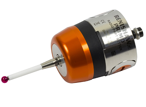

Victory Precisions was incurring huge losses in terms of time and material until it started using Renishaw's Primo system. The Primo system which consists of a Primo Radio Part Setter and a Primo Radio 3D Tool Setter, is available at a competitive price, and is aimed at delivering a fast return on investment. It enables automated on-machine part setting, part inspection and tool setting, helps to eliminate manual setting errors, and improves accuracy and part conformance whilst reducing non-productive time and scrap. This helps to increase productivity, improve quality, and increase profits.
The Primo system is easy to use, simple to install and represents a low initial financial outlay. Additionally, its exclusive, enhanced warranty offers users peace of mind. The innovative Primo Credit Token system offers users the flexibility to ‘pay-as-you-probe'. Its 6-month renewable tokens allow unlimited use of the Radio Part Setter and the Radio 3D Tool Setter within this period of time. The credit tokens are also available as an upgrade to enable unrestricted continuous use.
A key benefit is the elimination of the need for extensive G-code knowledge. The system is supplied with GoProbe, an innovative ‘all-in-one' software package that simplifies part setting, tool setting and calibration. Simple, single-line commands are used instead of multiple lines of code which further eliminates the need for any
special training.
While it is revolutionary, installing the Primo system is also very easy. Renishaw installed it within one and a half hours at Victory Precisions and the operators were trained to operate the probe in just three hours using Go Probe. Requiring no previous experience of probing, GoProbe makes the probe system easy to understand and use.
