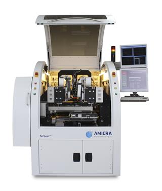

Example of an SMT (Surface Mount Technology) machine
