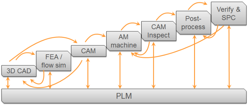

To be useful, every manufacturing process needs an effective chain of tools that work together to design, prepare, produce, control and verify the output. Variation creeps into processes from a wide range of sources, and the secret to productivity is an obsessive focus on identifying how variation can arise, and either designing it out of the process, or controlling it tightly if that's not possible.
A good process chain therefore encourages design around the most appropriate and controlled processes with user-friendly tools. It also supports multi-disciplinary teams to make the right decisions early, based on knowledge gained from good process data.

Albeit immensely powerful, AM must be underpinned by an effective process chain with user-friendly design tools and a range of post-processing and metrology before the parts it makes can be used in anger. Information must flow up and down the chain to link processes together.
