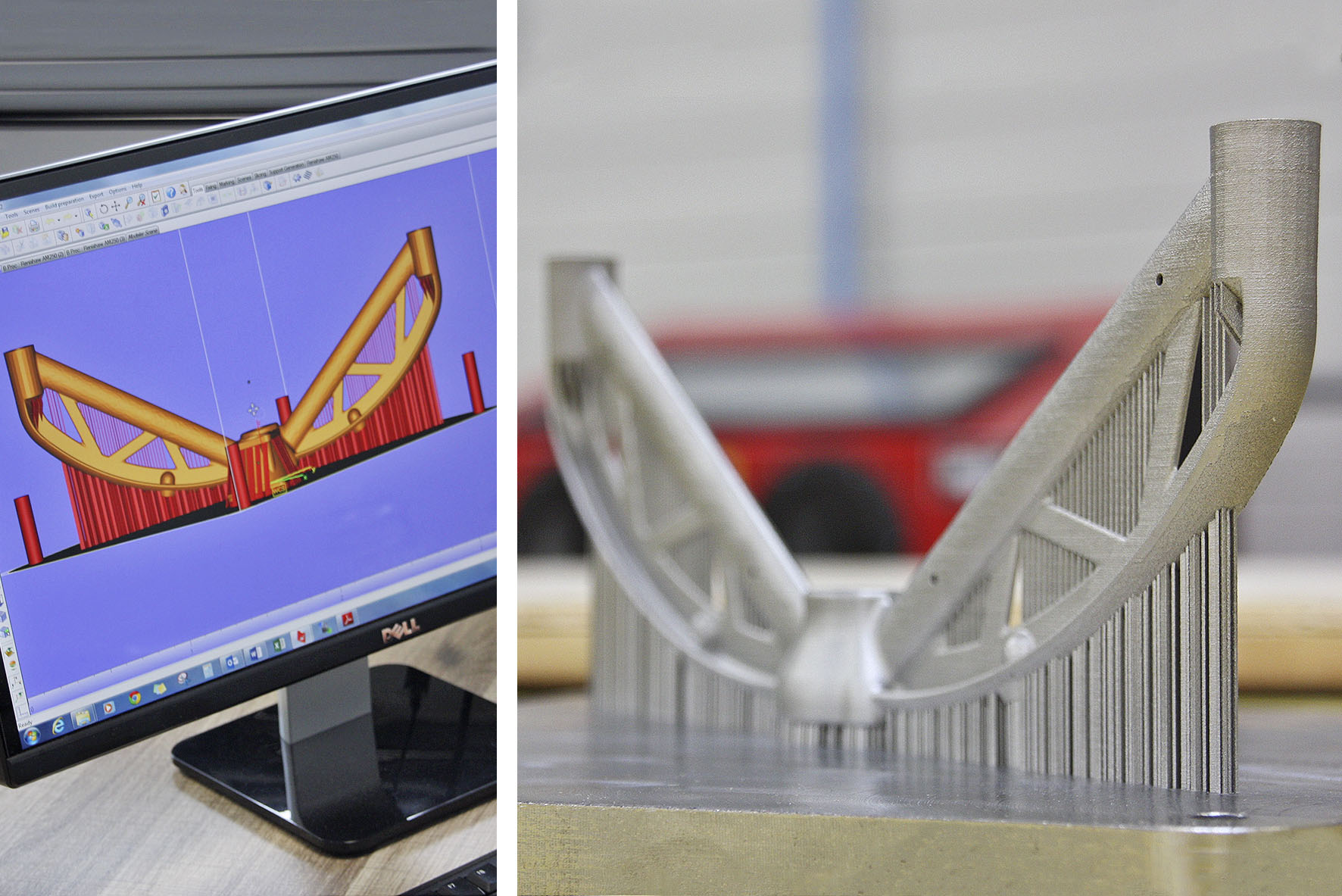

Key components of the front suspension are the wishbones; components that attach the fork to the motorbike chassis, enabling movement of the forks. The original upper wishbone component was handmade and assembled using twelve individually machined and welded parts.
I3D Concept, topologically optimised the shape of the part using CAD software. The new design reduced assembly time, decreased the weight by a factor of 40%, but as importantly, reduced the unsprung mass of the bike. This improved the suspension in terms of vibration management and responsiveness to braking and acceleration.
“Additive manufacturing allowed the TransFIORmers team to produce a precisely manufactured component in a highly competitive environment,” explained Christophe Tisserand, Additive Manufacturing Product Manager for Renishaw S.A.S.
The Optical Control System of Renishaw's AM250 additive manufacturing system enabled accurate control of laser steering, which enhanced precision, definition of features and surface finish.
