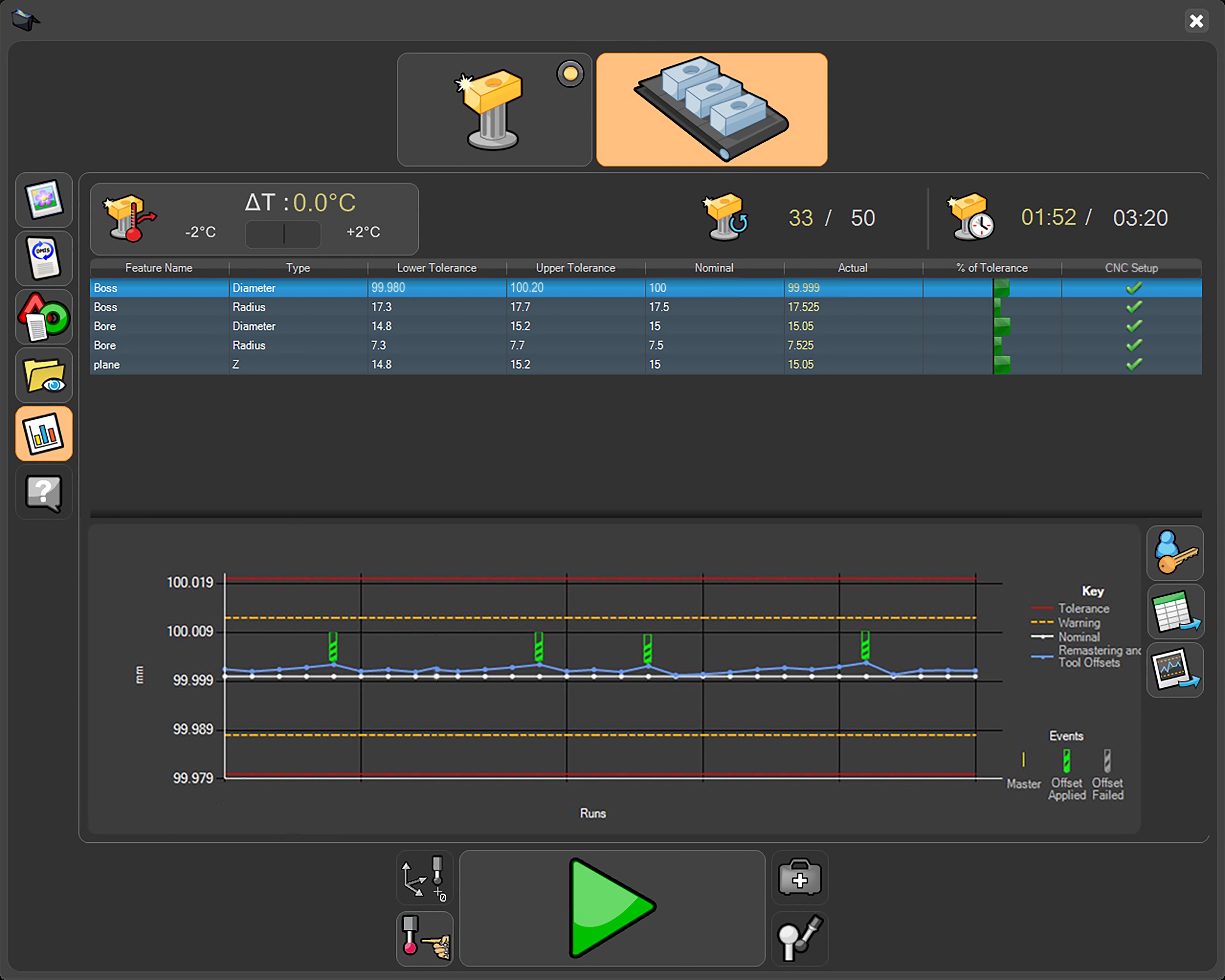

Controlling processes with frequent gauging
The new IPC software allows constant monitoring and adjustment of a machining operation, keeping part dimensions close to nominal and well within process control limits. This means that any process drift is quickly corrected, improving part quality and manufacturing capability, along with reducing scrap. The proximity of the Equator gauge to the CNC process allows rapid measurement and process adjustment at the point of manufacture, avoiding time delays or relying on finished part (tailgate) inspection.
The IPC software can average results across several parts to determine the true process mean for adjustment of each cutting tool. For process control purposes, it is usual that only one machined feature per tool offset will require gauging, as compared to many features for typical Quality Assurance (QA) applications. The frequency and control of offset updates can be configured on a feature by feature basis depending on design tolerances, process variation and tool wear rates.

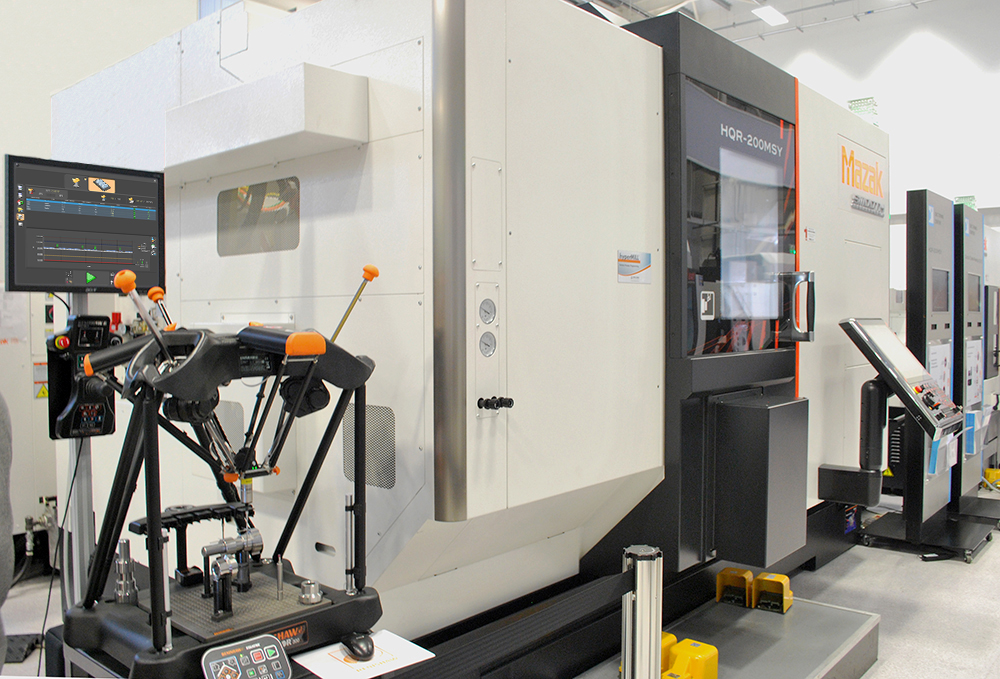

One-to-one or One-to-many – update multiple machines from one Equator gauge
An Equator gauging system can be connected to one or multiple CNC machine tools, so that parts from different machines can be gauged on one Equator, with the offset updates being sent to the corresponding machine (part / machine identification is required). Connection to multiple machines requires an Ethernet hub or is via an existing factory network. Closed loop unmanned process control of a cell of machines is possible and a key requirement when used in conjunction with factory automation systems.

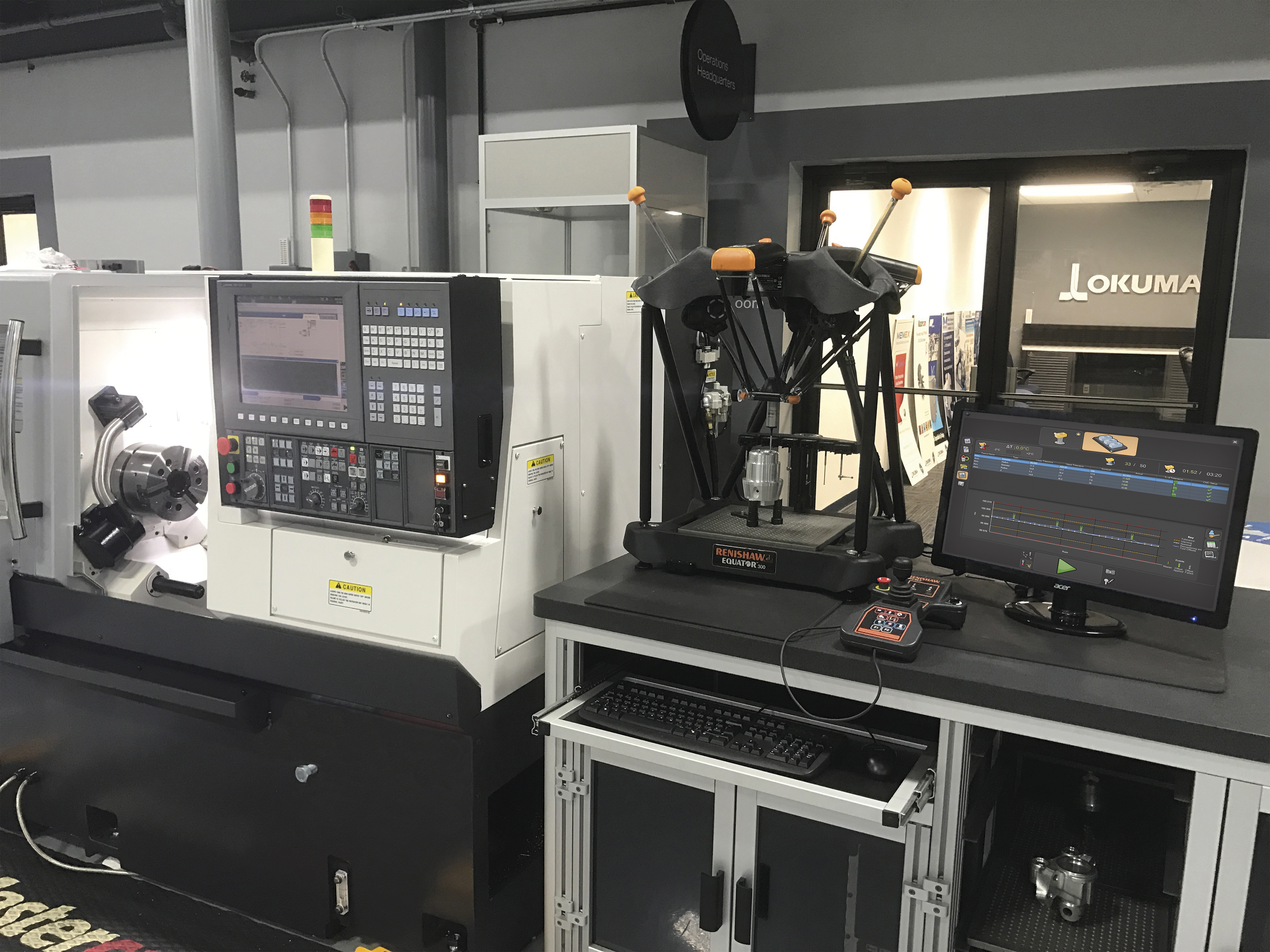

The first release of the new IPC software allows connection to one or multiple machine tools, with direct Ethernet links from the Equator Controller to Fanuc, Mazak and Okuma CNC controls.
Fanuc controls that have been tested and proven include the 0i, 30i, 31i and 32i, with the Focas2 option installed.
Mazak controls currently supported are the Smooth X, Smooth G, Matrix2 and Matrix controls with the Mazak API installed.
The Okuma OSP300L and OSP300M controls are supported, on machines with the Thinc API installed.
