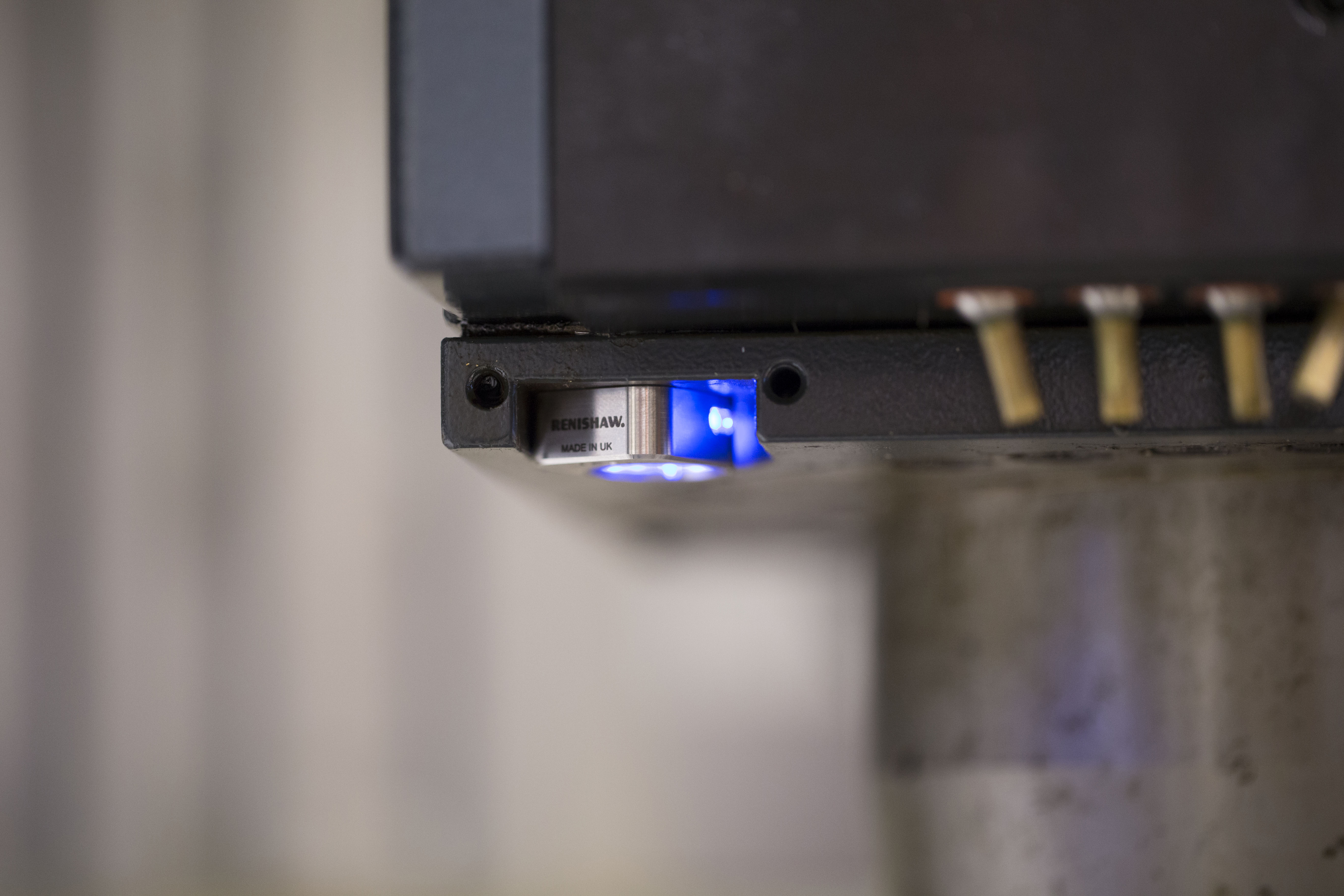

A new multi-probe optical interface system for machine tool probe systems will also be introduced at EMO Hannover 2017. Expanding on the highly successful OSI/OMM-2 optical probe interface system, the introduction of the new spindle-mounted OMM-2C receiver provides a compact and convenient solution allowing installation of up to three Renishaw machine tool touch probes with optical signal transmission communicating via a single interface.
System design ensures robust operation whatever the operating environment. Utilisation of Renishaw's ‘modulated' optical transmission technology offers unparalleled resistance to light interference, whilst an optional, integrated air blast ensures the receiver window remains clean and debris-free for uninterrupted system communications.

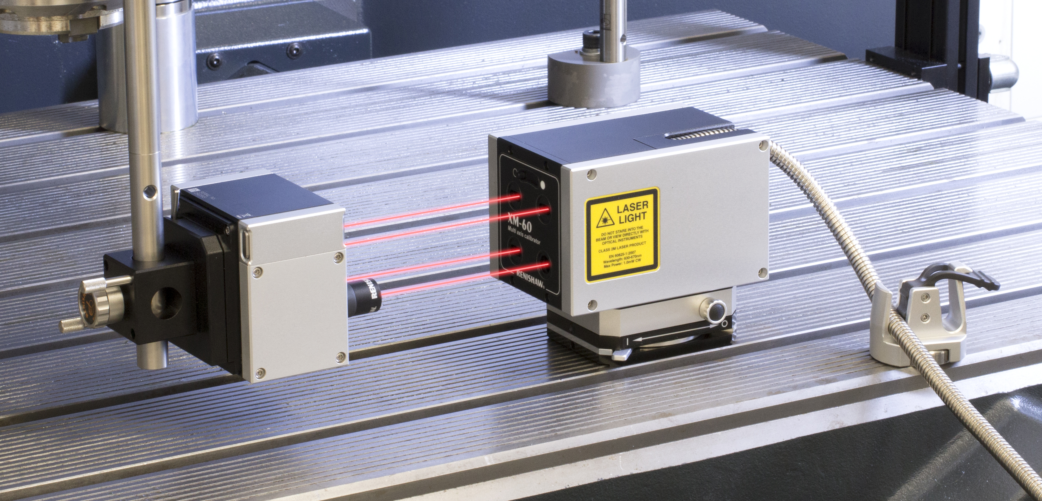

Building on the launch of the Renishaw XM-60 multi-axis calibrator in September 2016, the new release of CARTO 2.1 software brings valuable new functionality. The new ‘free-run mode' allows users of the XM-60 calibration system to capture data immediately, without having to define the positions, or even the number of targets. The software displays straightness (horizontal and vertical), pitch, yaw and roll errors against linear position. Triggering can be manual (with a keypress), automatic (based on stability of position) or continuous (captured during motion at a user-defined interval).
