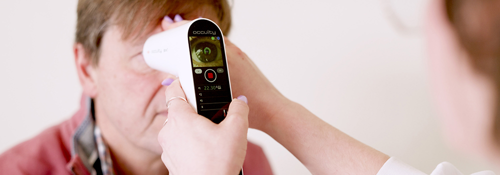

Launched in September 2024, Occuity's PM1 Pachymeter is the first in a series of handheld ophthalmic products designed to revolutionise healthcare screening. The PM1 measures corneal thickness with high precision, supporting the early detection and monitoring of eye health and disease, particularly glaucoma. Glaucoma is a group of eye diseases that damage the optic nerve, usually due to increased pressure in the eye. Vision loss from glaucoma is gradual and permanent, so it is critical to find and treat the condition as soon as possible.

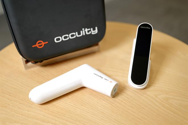

Building on the success of the PM1, Occuity has extended the range of its optical technology products. With a planned launch in 2026, Occuity's AX1 Axiometer™ is designed to measure corneal curvature and axial eye parameters. This enables the diagnosis and management of axial myopia, a condition caused by abnormally large axial lengths of the eye. If left unmanaged – especially in children – myopia can increase the risk of serious eye problems later in life, such as retinal detachment or glaucoma. The AX1 will be used in clinical and screening settings to support the detection of axial myopia, plan treatment, and monitor ocular health on an ongoing basis.
Dr Dan Daly, founder and CEO of OccuityDr Dan Daly, founder and CEO of Occuity
Occuity AX1 handheld AxiometerOccuity AX1 handheld Axiometer

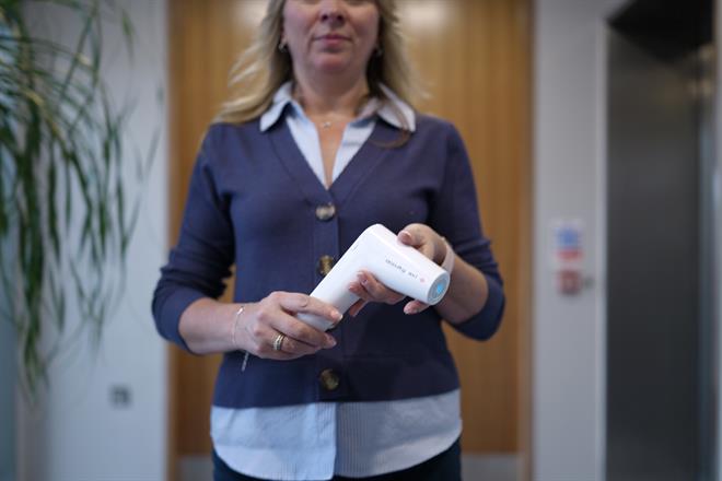

The AX1 will be the only handheld non-contact device capable of measuring axial eye length with an accuracy of ±25 µm – an unprecedented capability in a handheld device. As with the PM1, the portability and ease of use of the AX1 contrasts sharply with traditional bulky desktop equipment which requires chin rests, alignment systems, and trained operators. This makes the AX1 invaluable for eye health specialists who might be constrained by space limitations or who work in settings such as mobile clinics or schools.

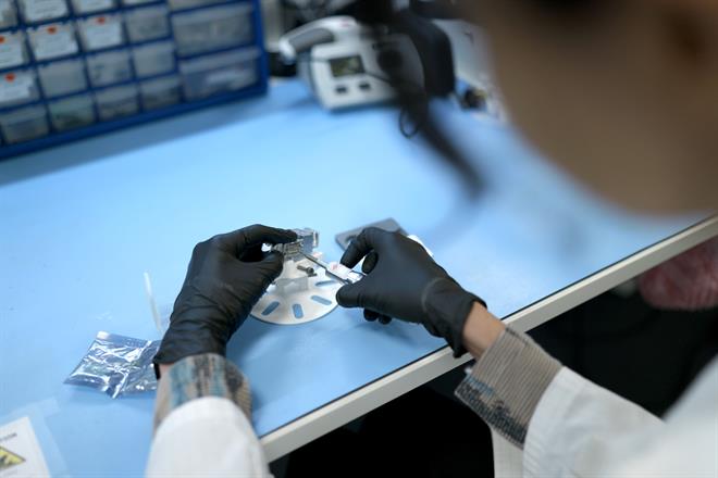

''ATOM DX is a high-resolution optical digital encoder that allows us to measure the position of our scanning system with ten times greater resolution,'' says Jamie Serjeant, Lead Engineer at Occuity. ''It's a 'drop-in' solution that meets our needs perfectly. It's also easy to install using the built-in mounting points that we designed our chassis around. By avoiding the need for precise manual location, we save invaluable time on the production line.''

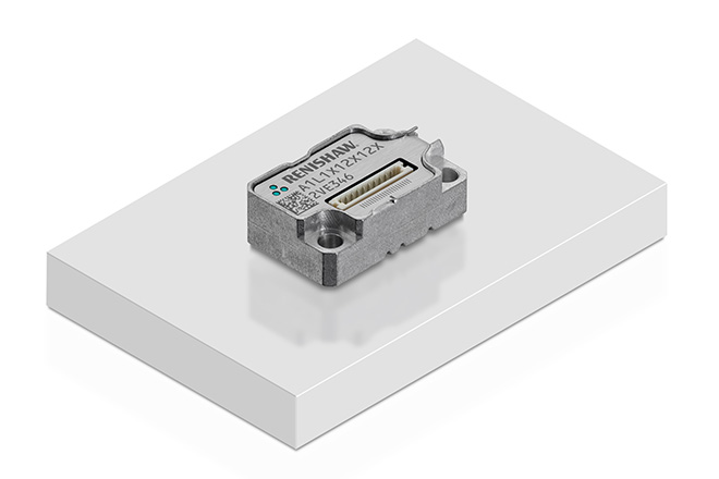

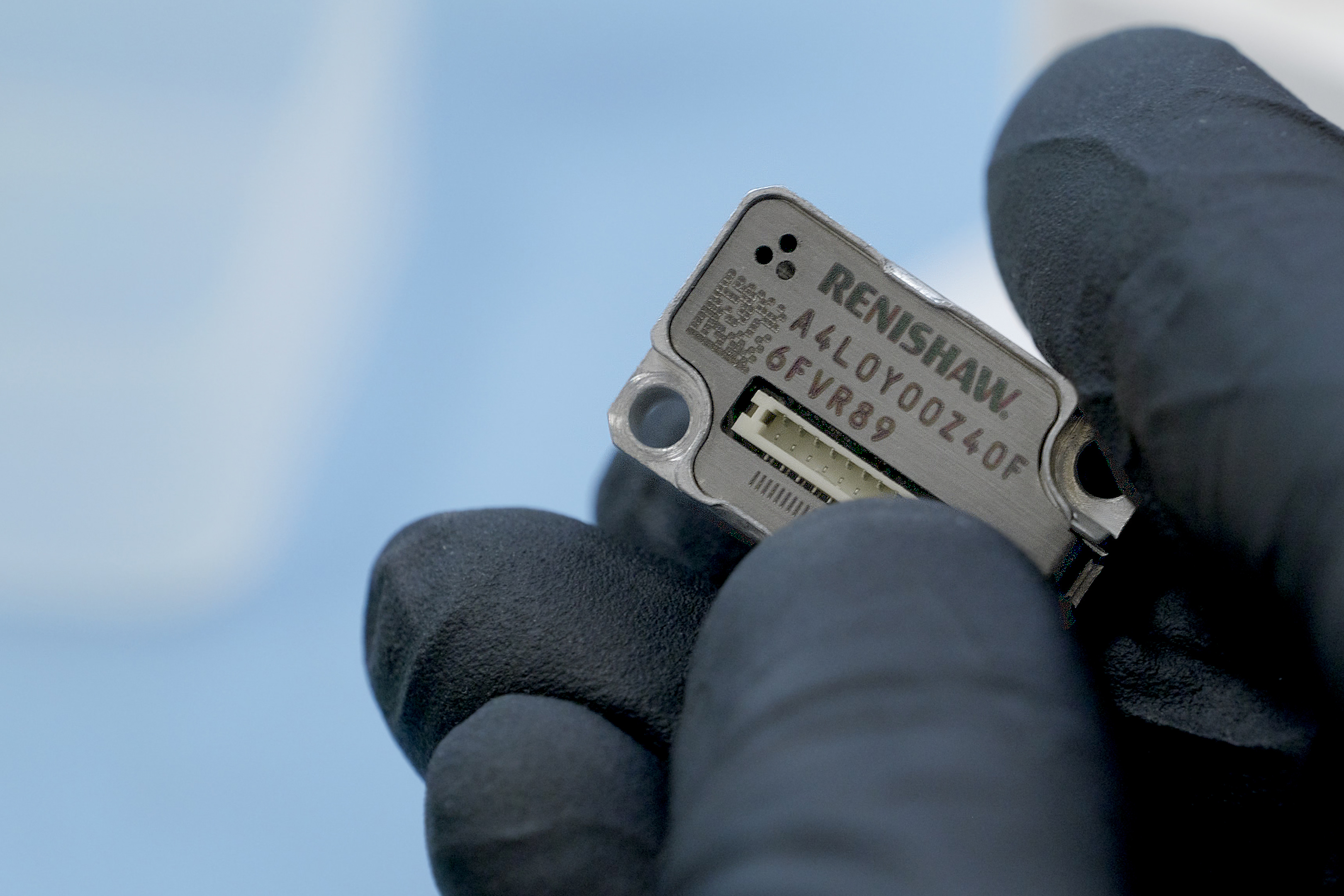

The ATOM DX encoder series is Renishaw's smallest digital incremental optical encoder. It provides positional feedback, incorporating onboard interpolation and filtering optics, making it ideal for compact or space-constrained applications.
The ATOM DX encoder is built on the optical system platform of the market-proven ATOM™ encoder. It integrates Renishaw's interpolation technology within the readhead, reducing the overall system size and eliminating the need for further adaptors or interfaces.
ATOM DX encoders are compatible with Renishaw's ADTpro-100 standalone encoder diagnostic tool and ADTi-100 diagnostic tool, both of which work with ADT View software. These tools provide detailed diagnostic information, supporting encoder set-up, optimisation, and fault analysis in the most complex of motion control systems.
ATOM DX encoder readheads can be used with a variety of linear, partial arc, and rotary scales in cabled and top-exit variants, with 20 µm or 40 µm scale options to suit different application requirements.

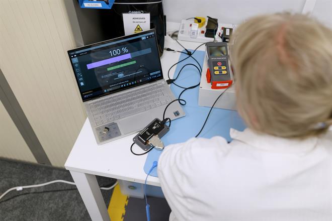

Occuity deploys Renishaw's ADTi-100 Advanced Diagnostic Tool on its production line to ensure that every ATOM DX encoder is set up correctly and performing well. The ADTi-100 connects to the ATOM DX readhead to display real-time signal strength, diagnostics, and calibration data, verifying installation quality. The ADTi-100 assists with challenging motion control installations, helping Occuity to set up and diagnose faults quickly and easily. This process guarantees that every AX1 shipped has been checked and that the Renishaw encoder is providing optimal performance.
Occuity checking encoder performance with the ADTi-100 Advanced Diagnostic ToolChecking encoder performance with the ADTi-100 Advanced Diagnostic Tool
