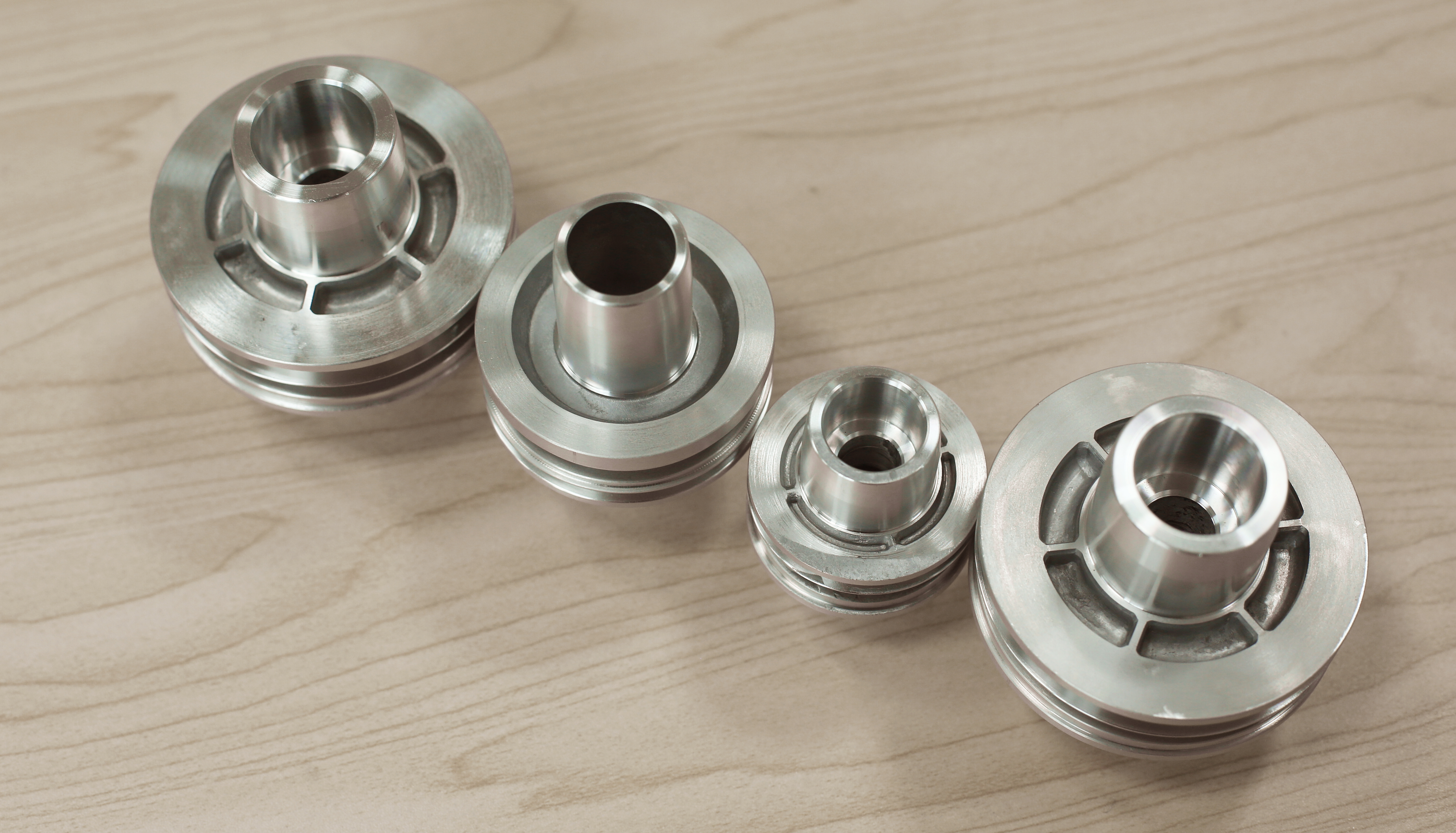

Pneumatic components
One of the main benefits we have found using the Equator is its ability to capture accurate measurement data. This completely removes the need for human intervention, which reduces the pressure on the operator to record data manually. In addition, the data is automatically saved in the Equator, which sends automatic feedback to the machine tools, which can be used for integration and trend analysis to identify whether any parts would need manufacturing enhancement.
