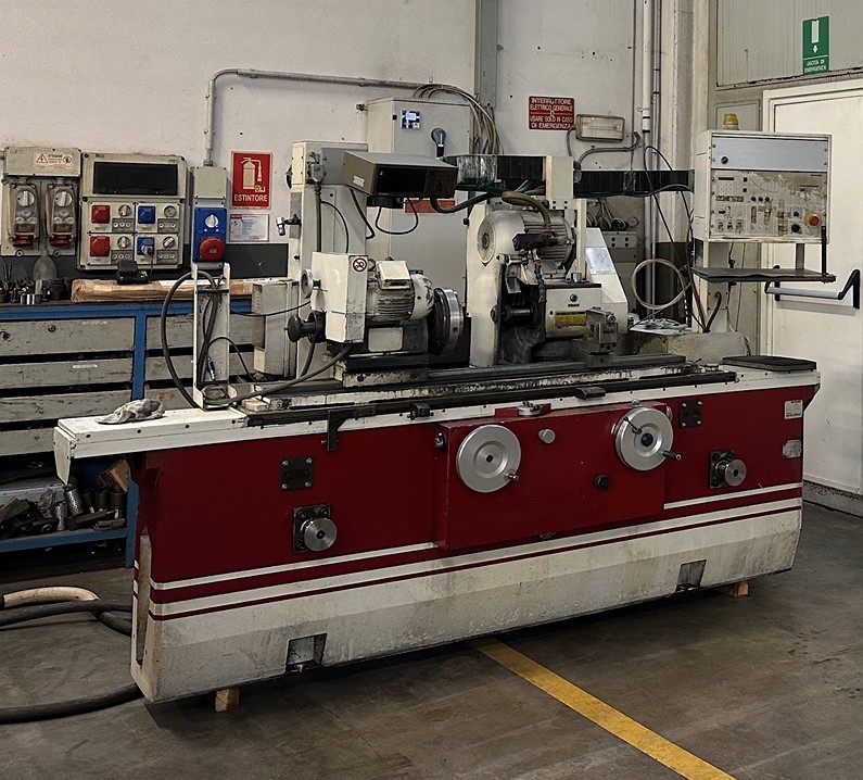

Euro Tecno Tool s.r.l., a customer of R.A.M. Service, owned an old Studer S30 grinding machine that faced production limitations with its outdated electronic system. “The Studer S30 is an old but great grinding machine,” Mr Monica says.
The axes were manually operated, which led to suboptimal precision and reliability, restricting the machine's capacity to meet the high-quality standards required for metal packaging. The machine's control panel had also deteriorated over 30 years of use and needed modernising.
Additionally, the customer needed to grind a specific shape that the machine was not originally designed to support.
The challenge was to redesign and rebuild the electrical and mechanical parts, ensuring the machine could meet modern precision standards and handle the required shape.

RAM Service - old Studer grinding machineStuder S30 grinding machine prior to retrofitting

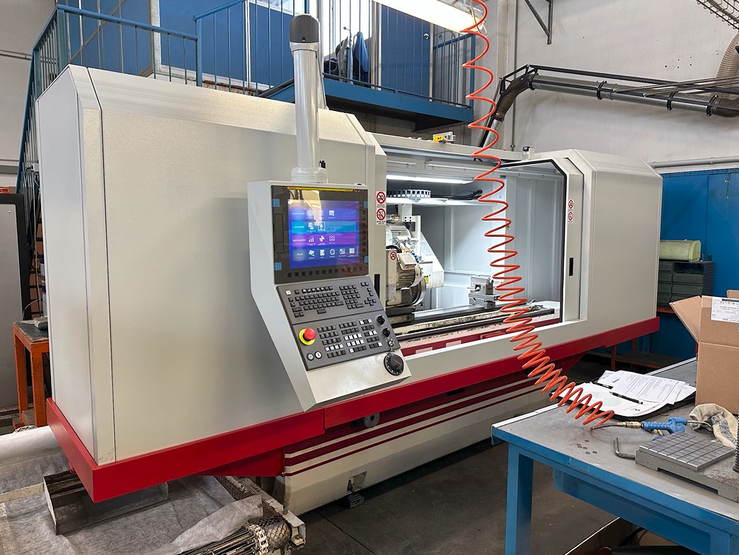

R.A.M. Service redesigned the Studer machine's electrical and mechanical parts, installing a new FANUC CNC system and the FORTiS scales. The result was a significant improvement in precision and the ability to machine complex shapes, meeting the client's needs effectively.

RAM Service - retrofitted Studer S30
Retrofitted Studer S30 machine
