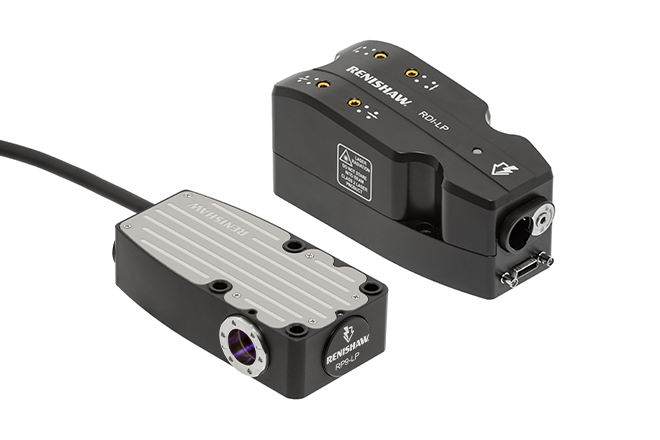

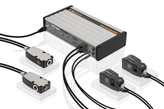

RLE300 laser unit, with 2 DI differential and 2 PMI plane mirror detector heads on white background

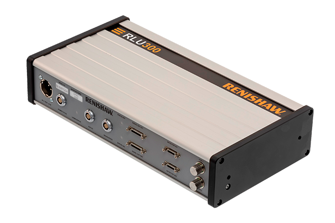

RLU300 laser unit for RLE300 laser encoder systems
DI differential and PMI plane mirror detector heads for laser encoder systems against white background
