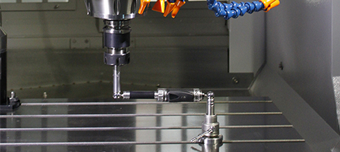

‘Working with a sculptor's precision' is a fundamental part of Jingdiao's corporate DNA, so product quality has always been the first order of business. The company has put this philosophy into practice by procuring the most advanced measurement and testing equipment and instrumentation to ensure product quality, even in the early stages of Jingdiao's development when funds were limited. This arsenal of advanced equipment and instrumentation includes Renishaw's laser interferometers and ballbars, which are used to assess the precision of machining centres. Using world-leading machinery calibration equipment like the XL-80 laser interferometer and QC20-W telescoping ballbar has enabled Jingdiao to maintain strict control over product quality. Moreover, both laser interferometers and ballbars are equipped with a variety of dynamic testing features and fault analysis functions, which provide a wealth of invaluable data for use in new product R&D and the improvement of manufacturing processes for existing products.
Jingdiao invests heavily in updating its production and measurement equipment every year. Over a number of years, the company has bought several dozen Renishaw laser interferometers, which it buys exclusively, as well as Renishaw's updated next generation XL-80 laser interferometers, QC20-W telescoping wireless ballbars and XR20-W wireless rotary axis calibrators. Recently Jingdiao has ordered another five XL-80 and XR20-W systems in preparation for its next phase of large batch production and quality control for five-axis machining centres.
This specialised equipment and strict quality management ensure the high quality of Jingdiao's products. Jingdiao has a strong technology R&D team and comprehensive quality assurance systems. The company has developed its own data capture interface to utilise the automatic pitch error compensation features of Renishaw laser interferometers during product calibration; this system sends data from the laser interferometers directly to Jingdiao's machining centres via a USB interface, enabling rapid, efficient and precise calibration of machinery.

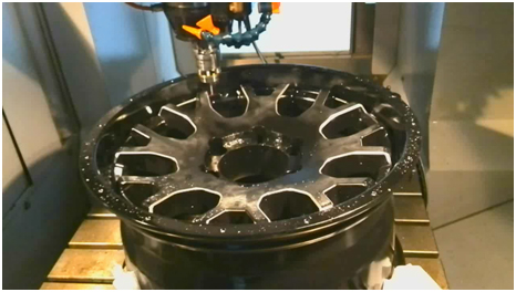

CNC precision engravers are extremely demanding in terms of the precision of processing product dimensions for glass grinding. The number of broken edges during the CNC mould making process have a direct impact on the product's throughput yield. Jingdiao have sold more than 10,000 machines specifically for these applications. Jingdiao selected Renishaw's OMP400 high precision measurement probes and their NC4 non-contact laser tool setting system for these applications, which involve strict dimensional precision requirements and high batch production yield rates.
Processing of equivalent-width chamfering on deformed wheel hubsThe OMP400 offers the benefits of high-precision three-coordinate measurement; it has a measurement repeatability of up to 0.25 microns and can achieve a level of measurement precision in machining centre environments that compares favourably with CMM units. Using the OMP400 solves problems with batch production such as product positioning and product deformation, ensuring that products meet the highest precision requirements. The NC4 non-contact laser tool setting system utilises laser beams to measure the dimensions of grinding wheels, while the measurement data is able to automatically update cutting tool parameters. The NC4 can be used to monitor grinding wheel wear and make instant repairs, not only saving time on grinding wheel measurement, but also guaranteeing high levels of measurement precision.
