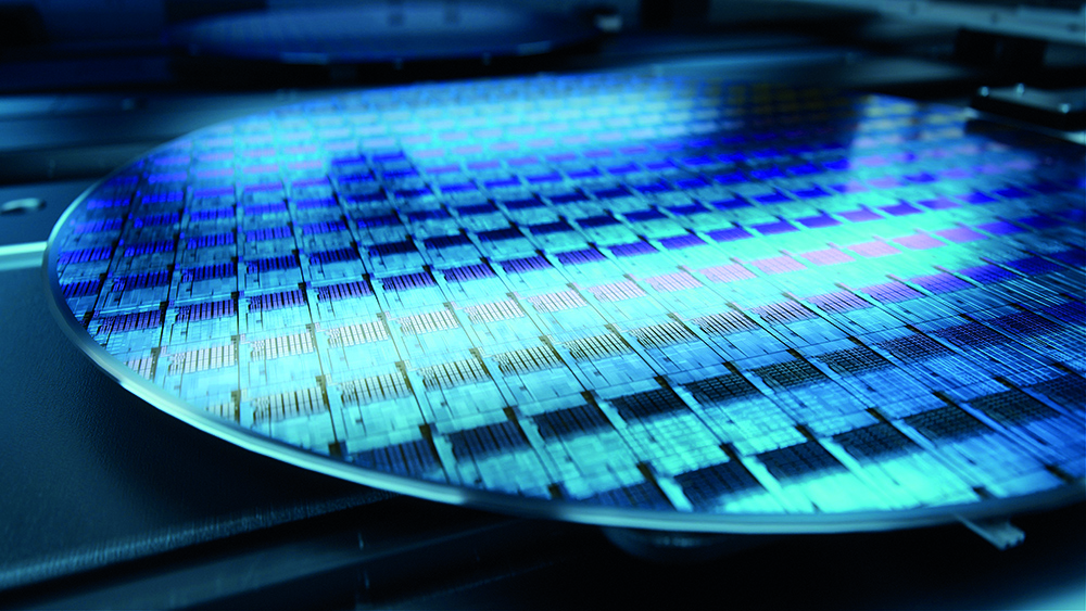

Many high-end semiconductor manufacturing processes require the processing environment to be completely free of any contaminants that cause imperfections within the semiconductor wafer and transistors being created. As the semiconductor industry moves to smaller feature sizes, larger wafers and more complex components with more processing steps, acceptable levels of wafer contamination are increasingly small.
These critical industrial processes take place in a vacuum because the presence of significant amounts of air or other gases would be detrimental to the finished product. Processes like semiconductor manufacturing that demand precision motion control need vacuum-compatible optical encoders for position feedback. Locating the position encoders within the vacuum chamber ensures that the measurement device is as close to the working environment as possible, ultimately minimising errors.

Semiconductor wafer during productionSemiconductor wafer during production
