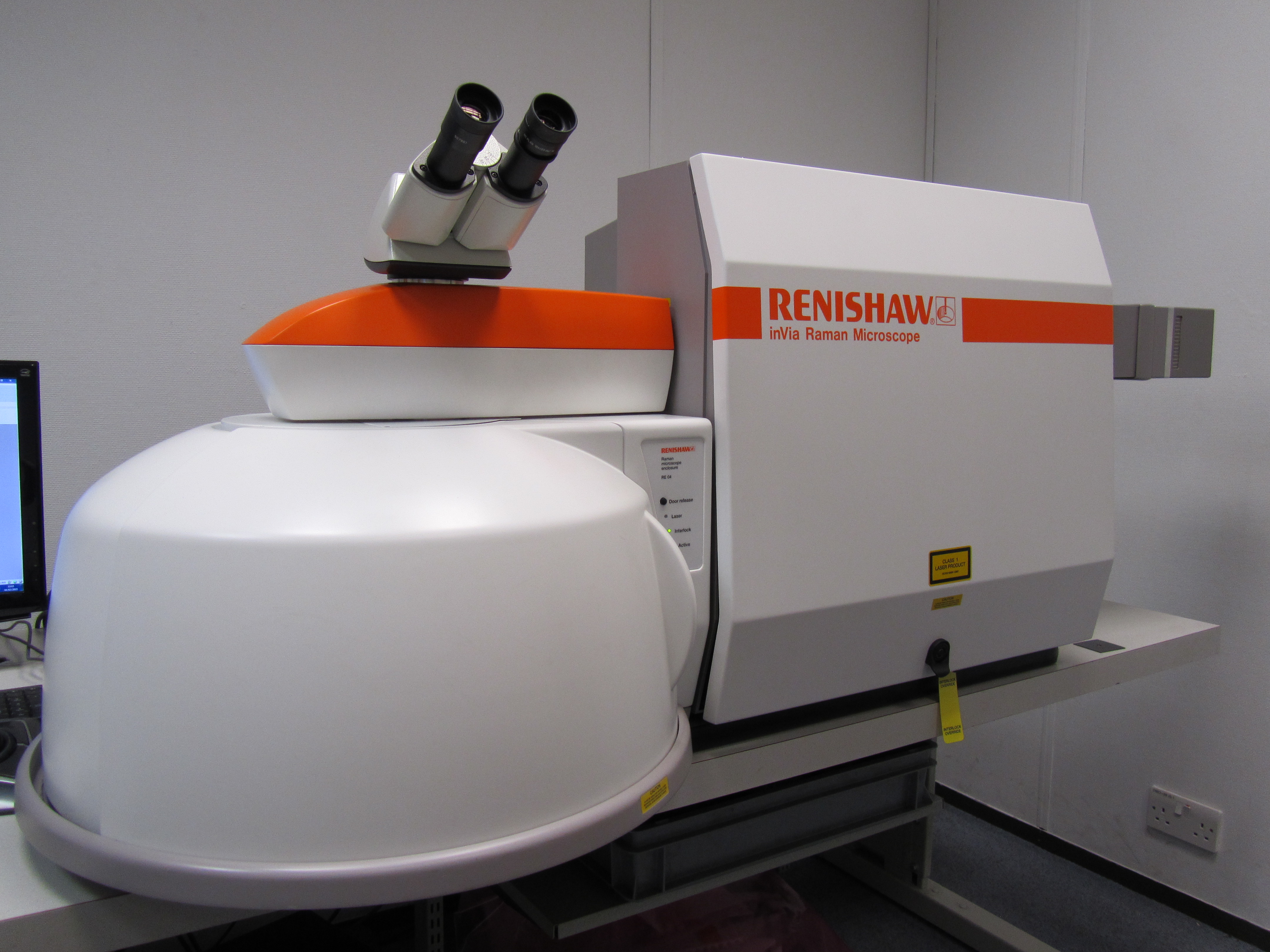

Image: The inVia Confocal Raman microscope
