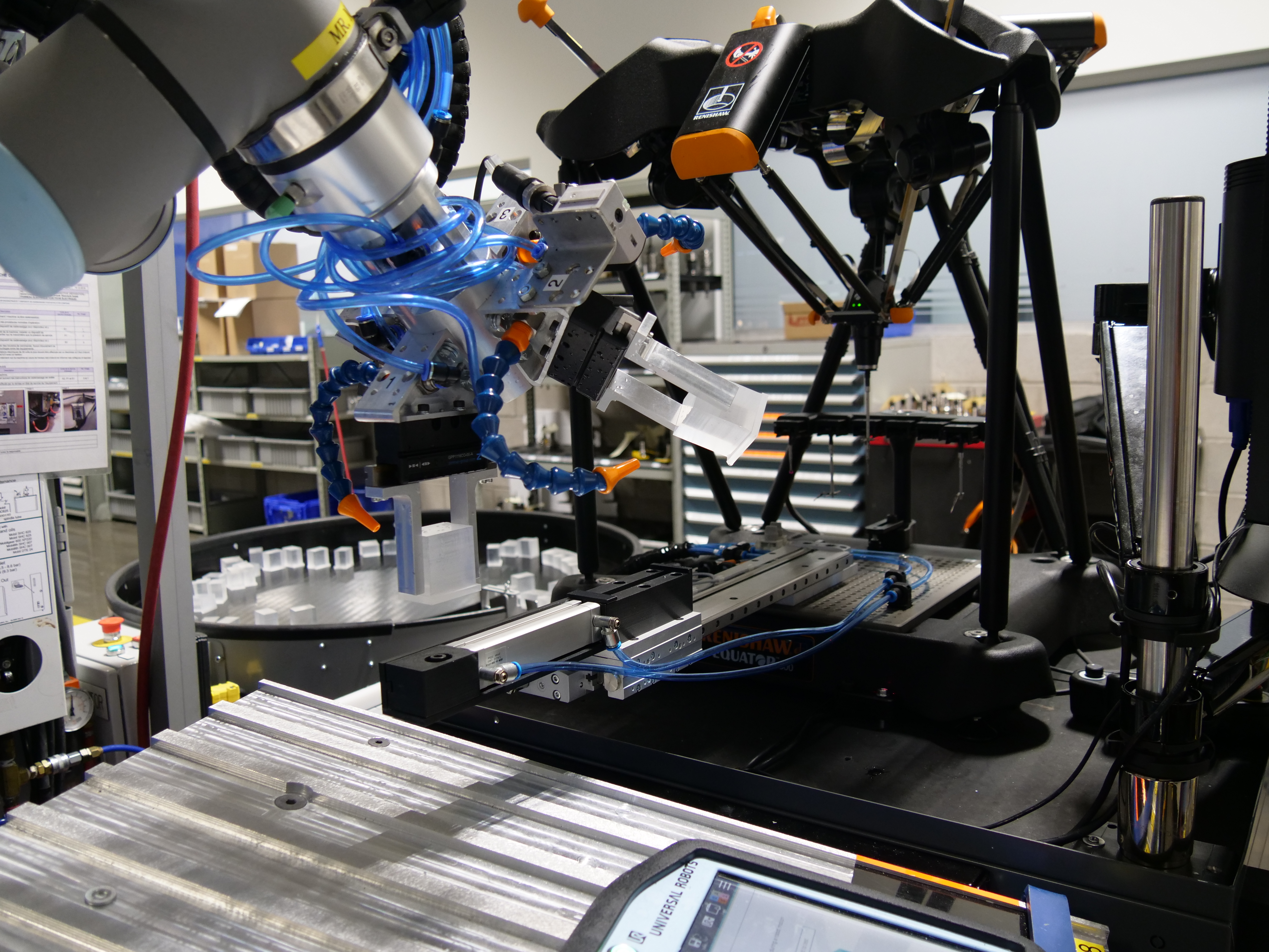

Equator gauging systems play an integral part in supporting manufacturers' drive to develop their own smarter processes and embrace factory automation.
The Equator system can operate at a temperature range of 5 – 50°C and up to 80% humidity and has been optimised for part loading via a robot or shuttle system. Configured for easy communication between the system and a variety of automated work cell equipment, integration into an automated cell is simplified. The result is significantly reduced cycle times, improved productivity and increased throughput.

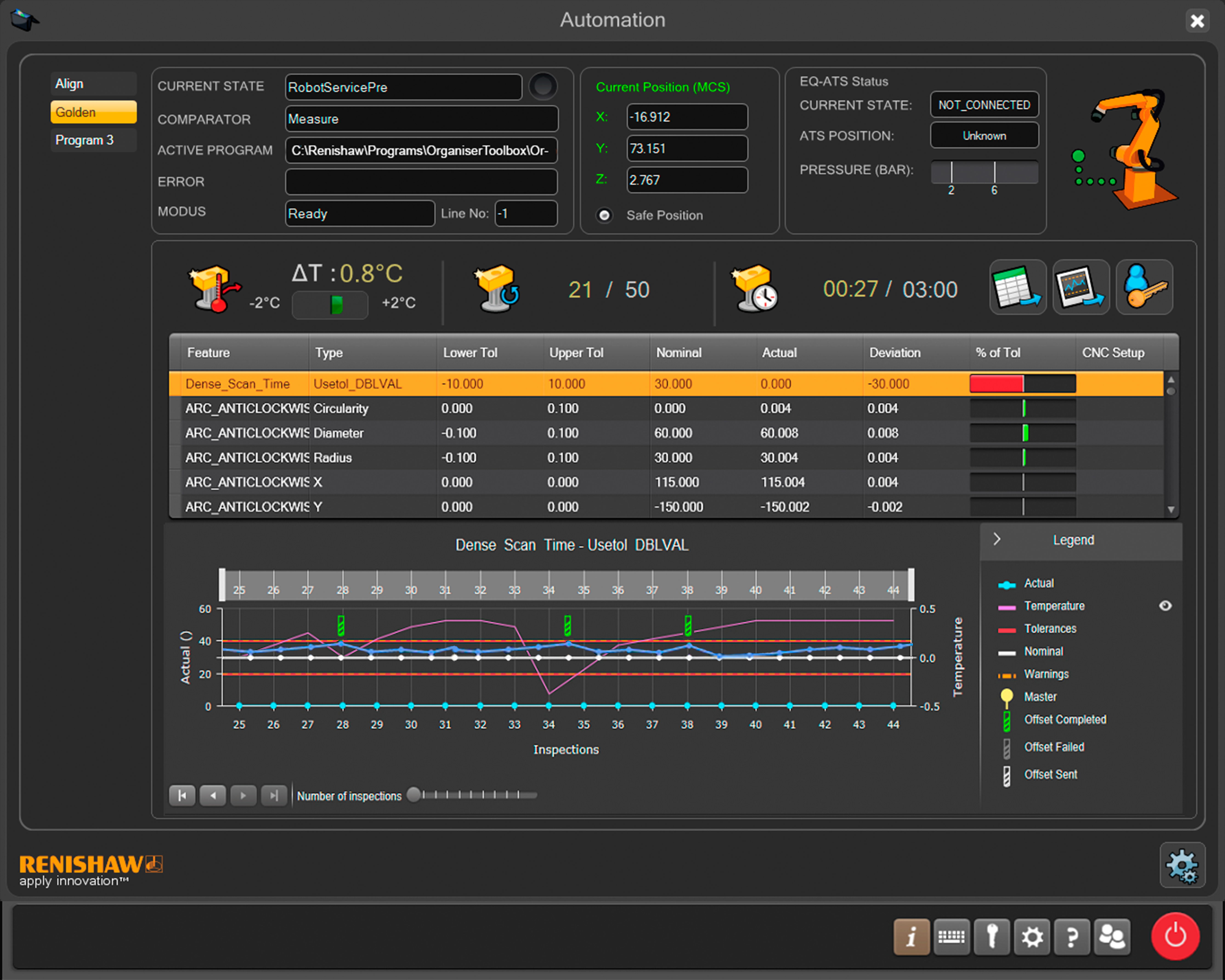

Process control is significantly improved with the move from sample inspection to 100% inspection, whilst the Equator system's Process Monitor function displays real-time gauging data bar graphs and charts, allowing for process corrections and scrap prevention.
Renishaw's Intelligent Process Control software (IPC) can record actionable data and provide automated real-time solutions, applying offset updates for common causes of instability such as tool wear and thermal drift.
An example of the effectiveness of the Equator gauge's level of automation led Olympus NDT, Canada, (who installed a system as part of a completely autonomous manufacturing cell) to conclude:
“Since we can now run the machine (tool) during the night and over the weekends, we have increased our machine capacity by almost 30%. We have reduced machine downtime, reduced the cost of scrap parts and improved the quality of parts produced.”

The REN-IO interface unit, coupled with the EZ-IO automation software, allows the Equator gauge to connect to a variety of external equipment in an automated cell with up to 32 digital IO connections. EZ-IO software simplifies the setup of automated manufacturing cells to configure communications between Equator systems and the cell controller.
