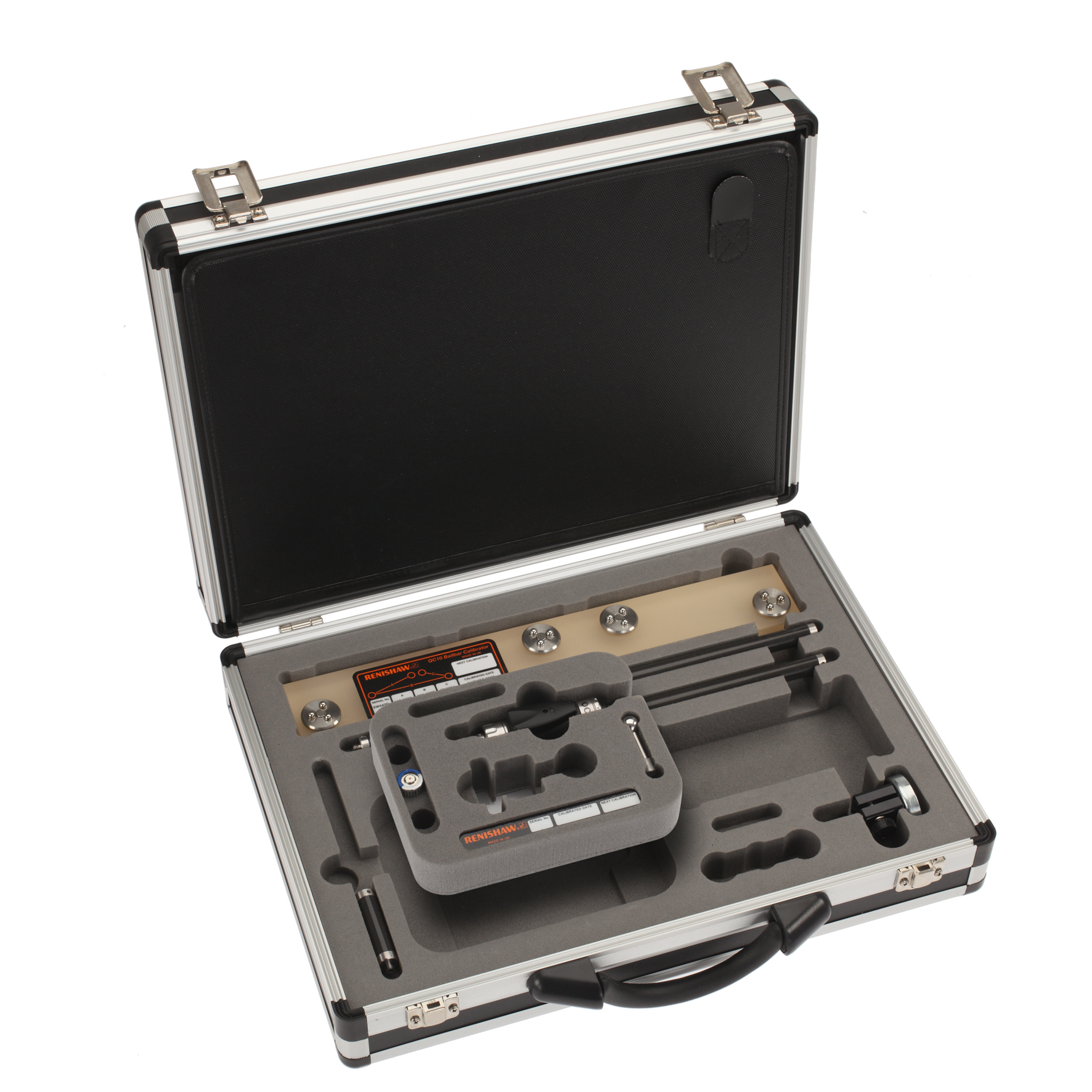

QC20-W upgrade kit in QC10 system caseAn upgrade kit is available to QC10 ballbar users at a very competitive price, especially if users are considering the cost of an upcoming recalibration for their existing QC10 ballbar. The upgrade kit is supplied as standard with an insert for fitting into the current QC10 case, with the new system case and additional hardware required for carrying out the new 3 plane testing available as options.
