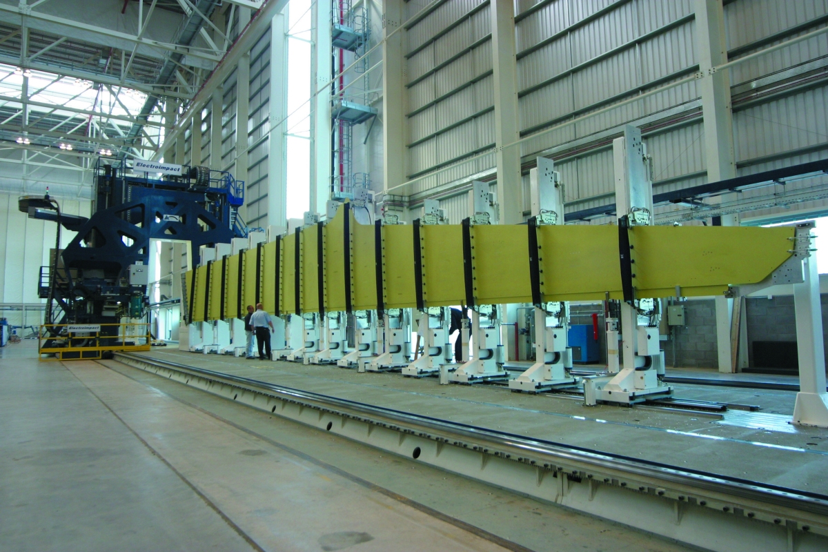

By virtually every measure of comparison, the new Airbus A380 Superjumbo, now under final construction in Europe, is the largest commercial aircraft in the world. Able to accommodate 555 passengers, and with a wingspan in excess of 260 feet, building the giant double-decker calls for some highly-innovative assembly techniques. One such technique is the use of several wing-panel assembly machines that depend upon Renishaw’s RG4 linear encoder systems for positioning accuracy.  The four machines incorporate over 1 km of 40 micron scale tape, to determine the precise position of travelling ‘yokes’.  These massive four-storey-high, 80 tonne structures straddle each skin panel in order to drill, tap and rivet stringers along the entire span.

Designated LVERs (low voltage electro-magnetic riveters), the huge twin-towered yokes run on beds capable of supporting all 16 of the wing panels involved. Each head must drill thousands of holes and apply all the rivets and bolts as it traverses the stringer/skin combinations, with their support columns. The heads must always be perpendicular to the skin surface and so have to adjust to match any combination of camber, aerofoil contour, dihedral, taper and sweepback, anywhere along the wing.
Fundamental to the process is the complex CNC riveting/drilling head and this in turn depends upon the linear accuracy, span-wise, of the whole yoke structure as it picks up signals from the RG4 linear encoder system.

An open, non-contact, optical linear encoder, the RG4 system has a range of compact readheads offering resolutions from 10 micron to 0.1 micron, speeds in excess of 10 metres/second, industry standard outputs, and compatibility with Renishaw’s novel ‘RGS40’ tape scale. Supplied on a reel, the self-adhesive, flexible scale was simply cut to the length required and fitted in-situ along the full traversing distance of the 160 m-long machine. It is protected against the ingress of dirt, liquids etc and, once installed, is largely unseen and undemanding. The four Electroimpact lines in the initial ‘Stage Zero’ wing-panel assembly stations each have one LVER already installed, with second units on each machine in the course of construction, to bring the total number up to eight.
