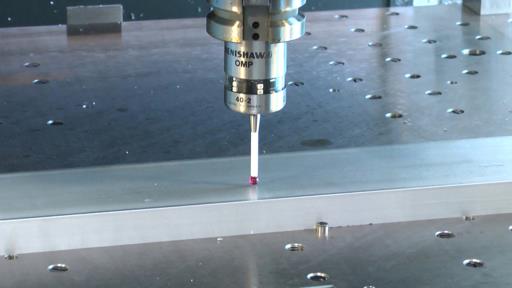

Machine tool probes for component setting and inspection
Renishaw probe systems provide an innovative solution to improve the efficiency of your machine tools. Touch probes on CNC machining centres and lathes can be used to identify and set-up parts, measure features in-cycle for adaptive machining, and verify finished component dimensions.
Save time. Reduce scrap. Stay competitive.

Benefits of component set-up
Probing eliminates the need for expensive fixtures and manual setting with dial indicators. Probes are spindle-mounted on machining centres and turret-mounted on turning centres, giving the following benefits:
  • Reduced machine downtime
  • Automatic fixture, job alignment and rotary axis set-up
  • Elimination of manual setting errors
  • Reduced scrap
  • Increased productivity and batch size flexibility
Benefits of on-machine component inspection
Spindle and turret-mounted probes can also be used for in-cycle gauging and first-off inspection.  Manual gauging relies on operator skill or the removal of parts to a CMM, which is not always practical. Benefits of inspection probing include:
  • In-cycle part measurement with automatic offset correction
  • Increased confidence in unmanned machining
  • Adaptive machining, providing process feedback to minimise variation
  • First-off inspection with automatic offset update
  • Reduced machine downtime awaiting first-off inspection results
