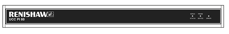

UCC PI 80 - front panel

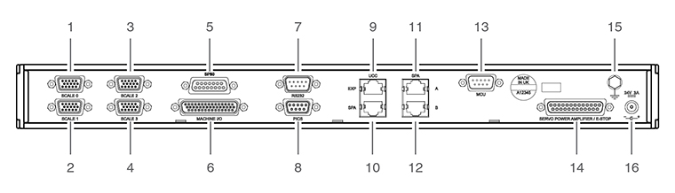

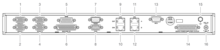

UCC PI 80 rear panel - labelled
Key
Description
Key
Description
1
Scale 0 interface (15W HDD socket) *
9
UCC - EXP (RJ45 socket)
2
Scale 1 interface (15W HDD socket) *
10
UCC - SPA (RJ45 socket) *
3
Scale 2 interface (15W HDD socket) *
11
SPA - A (RJ45 socket) **
4
Scale 3 interface (15W HDD socket) *
12
SPA - B (RJ45 socket) **
5
SP80 interface (15W D socket)
13
MCU (9W D plug) *
6
Machine I/O (44W HDD socket) *
14
Servo power amplifier / E-STOP (25W D socket) *
7
RS232 (9W D plug) *
15
Earth terminal
8
PICS (9W D socket) *
16
UCC PI 80 power jack (6.3 mm socket)
* NOTE: Only to be used when interfacing to an SPA2-2 (see the UCC BI installation guide, Renishaw part number H-1000-7602) or when using a third party amplifier (see the UCC AI installation guide, Renishaw part number H-1000-7611), otherwise the SPA3 / SPA3-2 connections should be used.
** NOTE: Only to be used when interfacing to an SPA2-2 (see UCC BI installation guide, Renishaw part number H-1000-7602).
