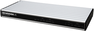

PHC10-3 PLUS probe head controller
Dedicated head controller for the PH10 range of motorised heads for use with OEM machine controller systems
 Replaces the PHC10-3 and the PHC10-2 and provides support for RS232 and USB communications Replaces the PHC10-3 and the PHC10-2 and provides support for RS232 and USB communications
- Uses a 24 V external power supply, manages all the PH10 and PH10 PLUS head functions and interfaces with the CMM's computer
- Does not manage the probe functions but does have the provision for a PI 200-3 or PI 7-3 interface card to be fitted internally
PHC10-3 PLUS (A-5863-0100)

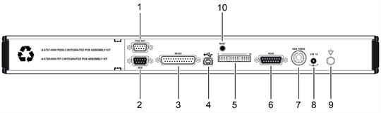

| Key | Description |
| 1 | 9-way D-type plug for PICS output |
| 2 | 9-way D-type connector to HCU2 |
| 3 | 25-way D-type plug RS232 communications connector to CMM computer |
| 4 | USB type "B" socket |
| 5 | |
| 6 | 15-way D-type connector to probe head |
| 7 | 7-pin DIN raw probe connector to probe interface or multiwire input for internal interfaces |
| 8 | |
| 9 | |
| 10 | Reset button |

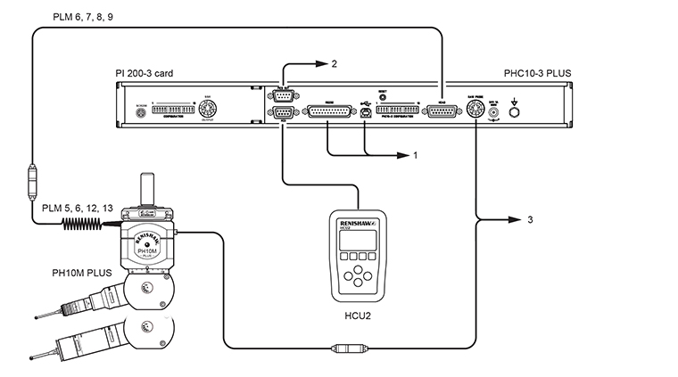

PH10 PLUS system with standard two wire touch-trigger probes
With internal PI 200-3

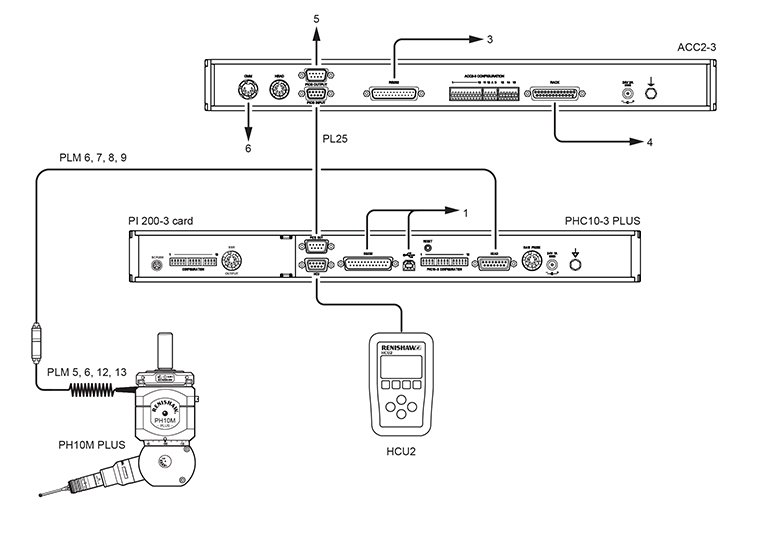

With internal PI 200-3 and autochange
 | Key | Description |
| 1 | Communication connection to CMM controller RS232 or USB |
| 3 | Communication to CMM controller |
| 4 | Communication to autochange rack |
| 5 | PICS output to CMM controller |
| 6 | Probe output to CMM controller |

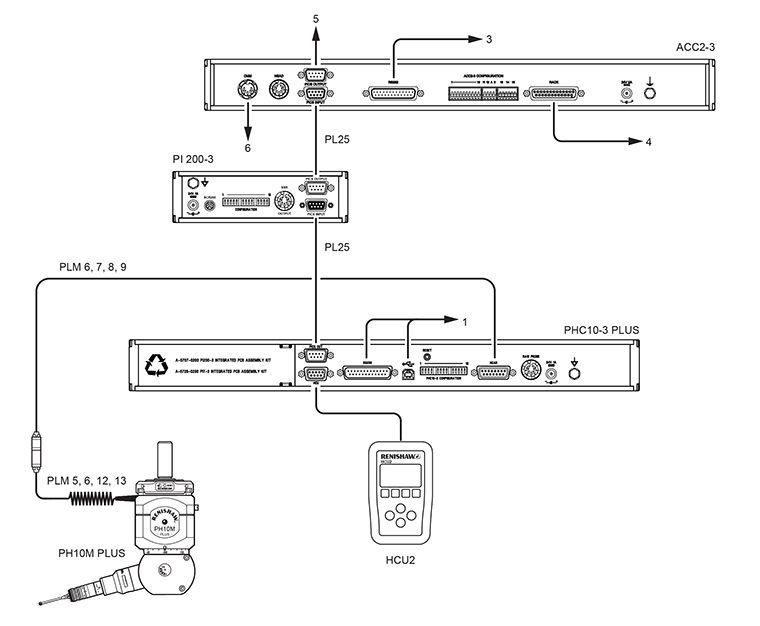

With external PI 200-3 and autochange
 | Key | Description |
| 1 | Communication connection to CMM controller - RS232 or USB |

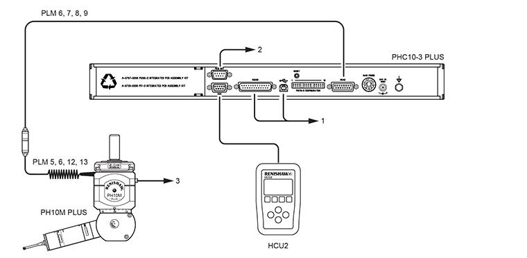

PH10 PLUS system with multiwire scanning probes
 | Key | Description |
| 1 | Comms to CMM controller |
| 2 | PICS to CMM controller |
| 3 | Multiwire to probe interface |
