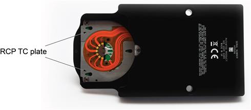

WARNING: The RCP TC or RCP TC-2 plate may be hot.
RCP TC plate
