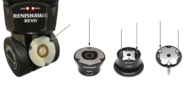

Kinematic couplings
The kinematic coupling mechanisms incorporated throughout the system have precision ball seating and permanent magnets. It is recommended that all these features be cleaned before first use, and thereafter at regular intervals.
A cleaning kit for the precision ball seating and permanent magnet is available from your Renishaw supplier (part number A-1085-0016). It comprises strips of ‘yellow tack' material. Use the yellow tack to clean the areas indicated with arrows on the image below.
REVO SFP1 system maintenance
With clean hands, tear off a small piece, shape into a small ball and press into / onto each of the features in turn, rotating to a fresh piece of material as you work around.
CAUTION: Ensure no yellow tack debris is left on the surface. The yellow tack should not be used for the optical windows or electrical contacts.
Electrical contacts
The electrical contacts, indicated with arrows in the image below, should be carefully cleaned with an alcohol-based cleaner (e.g. IPA) and a lint-free cloth.
