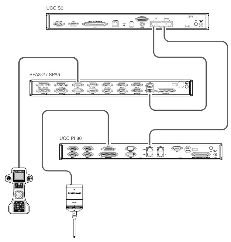

3-axis CMM with brushed motors
UCC PI 80 connectivity - UCC S3_SPA3-2_SPA5_UCC PI 80_SP80_MCU

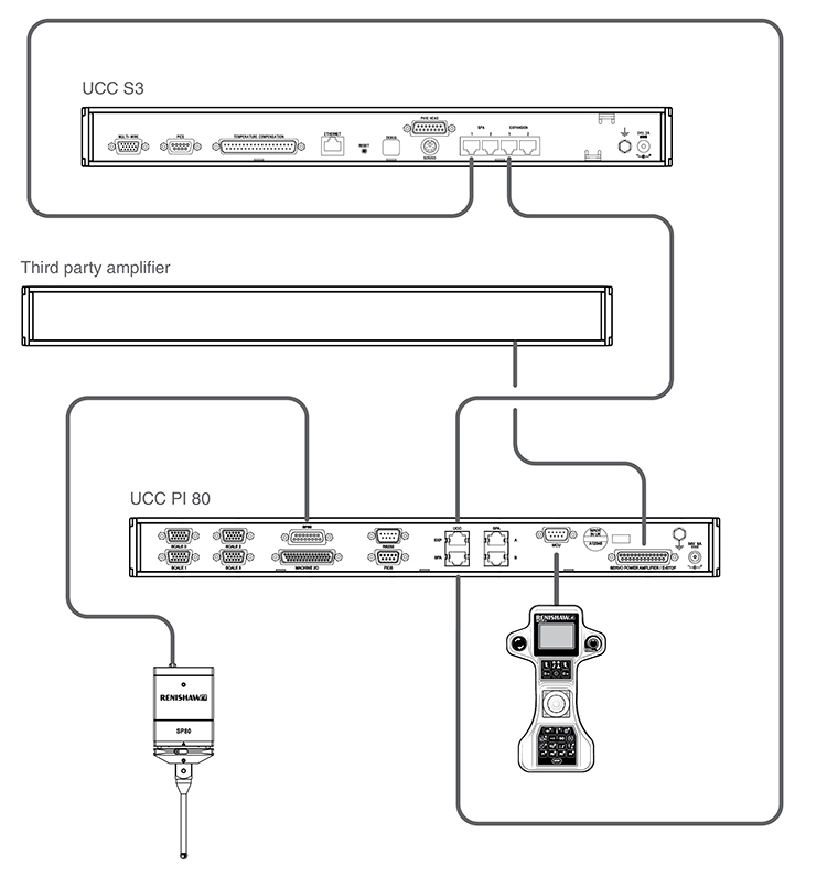

3- or 4-axis large CMM with motors requiring an analogue servo power amplifier
UCC PI80 connectivity - UCC S3_third-party amplifier_UCC PI80_SP80
