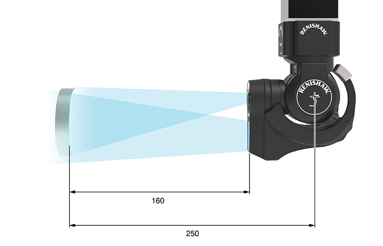

Probe length and stand-off
Probe length is the distance between the A-axis centre of the REVO-2 head and the centre of the measurement volume. This is equivalent to the probe length for RSP2 and RSP3 probes. Stand-off is the distance between the end of RFP1 and the plane at the centre of the measurement volume.
RFP stand off dimensions

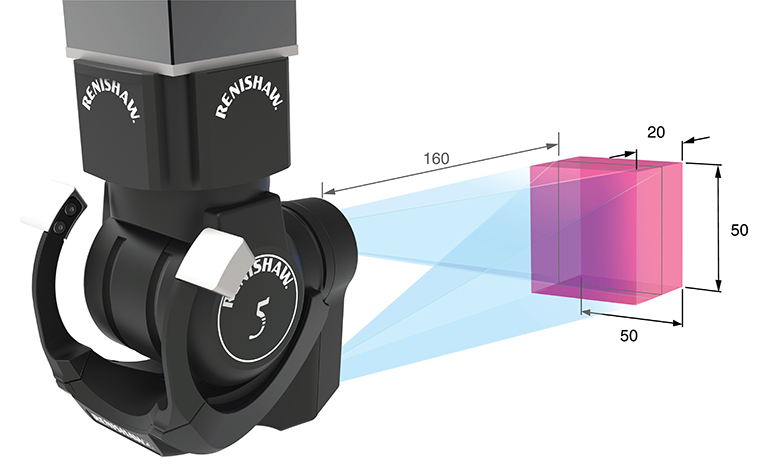

Measurement volume
Data will be returned from surfaces within the measurement volume and in line of sight of the projector and camera. No data will be returned from areas of the fringe pattern falling on surfaces outside of this volume.
RFP volume red dimensions
