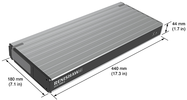

Dimensions
Width
Depth
Height
Weight
440 mm (17.3 in)
180 mm (7.1 in)
44 mm (1.7 in)
2.1 kg (4 lb 10 oz)
The UCC MMI-2 can either be free-standing or used in a 19 inch rack system.
WARNING: Ensure the UCC MMI-2 is disconnected from the mains supply during installation.
UCC MMI-2 dimensions

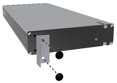

Mounting in a 19 inch rack (optional)
NOTE: The screws supplied with this kit are M5 × 6 mm countersink type.
The rack mounting kit (Renishaw part number A­-5518-0005) contains two brackets and four M5 × 6 mm screws. Assemble the brackets to the UCC MMI-2 as shown below:
UCC MMI-2 fitting mounting bracket
