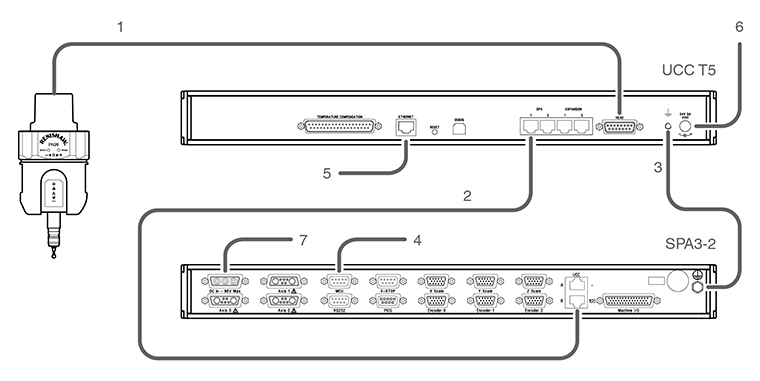

UCC T5 system connection
Earth bonding scheme
Generic UCC and dual SPA earth bonding scheme
PH20 interconnection diagram
UCC T5 and SPA3-2 interconnection diagram
Key
Description
1
PH20 orange head cable
2
CAT 5E 300 mm cable (supplied)
3
16 / 0.2 mm earth connection
4
MCU connection
5
CAT 5E ethernet cable (5 m cross-over cable supplied) to host PC
6
24 V power supply (supplied)
7
24 V - 80 V power supply (not supplied)

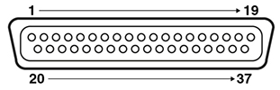

Temperature compensation connector
Pin number
Channel
Pin number
Channel
1
Channel 1 input
20
Channel 1 return
2
Channel 2 input
21
Channel 2 return
3
Channel 3 input
22
Channel 3 return
4
Channel 4 input
23
Channel 4 return
5
Channel 5 input
24
Channel 5 return
6
Channel 6 input
25
Channel 6 return
7
Channel 7 input
26
Channel 7 return
8
Channel 8 input
27
Channel 8 return
9
Channel 9 input
28
Channel 9 return
10
Channel 10 input
29
Channel 10 return
11
Channel 11 input
30
Channel 11 return
12
Channel 12 input
31
Channel 12 return
13
Channel 13 input
32
Channel 13 return
14
Channel 14 input
33
Channel 14 return
15
Channel 15 input
34
Channel 15 return
16
Channel 16 input
35
Channel 16 return
17
Reserved
36
Reserved
18
Reserved
37
Reserved
19
Reserved
Shell
GND
The thermistors for each channel connects between the CH input and CH return numbers. The return signals are NOT zero volts and MUST NOT be connected to any zero volt signal, GND or screen.
NOTE: For more information regarding the set up and usage of axis and work piece sensors, please read the temperature compensation page of this installation guide.
