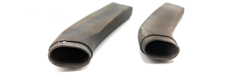

Our thinking was quite simple. By manufacturing the component horizontally, we could minimise the time spent producing the specific batch and help meet Angel Cycle Works budget target. It also meant we were better able to measure and handle deformation, as the chainstay bracket is long and thin, measuring 35 mm x 20 mm x 115 mm.

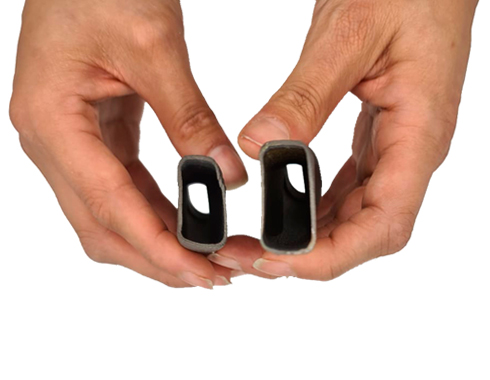

Comparison of a hand-welded chainstay bracket and metal 3D printed componentComparison of a hand-welded chainstay bracket and metal 3D printed component

“The challenge for Angel Cycle Works in manufacturing the titanium chainstay bracket component by hand fundamentally relates to the source metal itself. It simply isn't the easiest of materials to work with. Particularly when hand-welding, deformations in the component's integrity can occur, and staying perfectly true to a three-dimensional CAD model can be really very hard.”

Considering the component's structure and dimensions, building-up in a vertical orientation was the obvious, and generally optimal, first choice. However, recognising the potential deformation issue and the need to maximise productivity, Optimus3D chose to build-up in the horizontal orientation.
Capellan explained, Our thinking was quite simple. By manufacturing the component horizontally, we could minimise the time spent producing the specific batch and help meet Angel Cycle Works budget target. It also meant we were better able to measure and handle deformation, as the chainstay bracket is long and thin, measuring 35 mm x 20 mm x 115 mm.

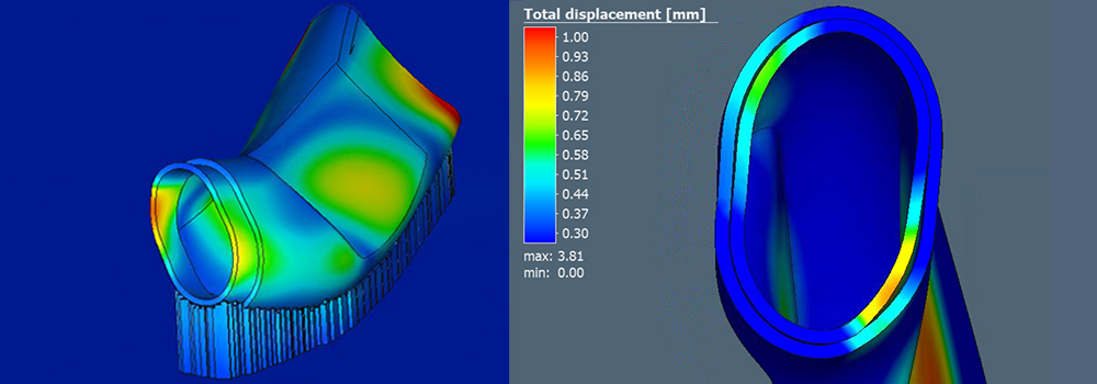

As expected, manufacturing the component horizontally direct from the CAD file yielded an unacceptable 0.375 mm distortion in the most vulnerable area. To remove this error, we teamed up with Renishaw engineers to arrive at an elegant solution that was based on finite element simulation.
Alex Garcia, Renishaw Application Engineer, explained, Using third party Simufact Additive software, we were able to perfectly simulate the powder bed fusion process of the RenAM 500S system. What this then enabled us to do was to determine a precise compensation factor that could be used to accurately 'pre-distort' the component design.
Analysis of the additively manufactured titanium chainstay bracket using Simufact softwareAnalysis of the additively manufactured titanium chainstay bracket using Simufact software

While perhaps counter-intuitive to much common thinking, Optimus3D's decision to build-up components horizontally and employ simulation software to adjust the design for manufacture has seen worst case deformation reduced from 0.375 mm to 0.086 mm, well within the component's 100 µm tolerance.
