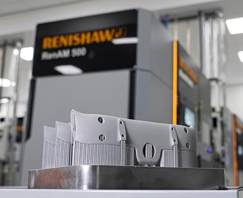

  • Parts printed on the RenAM 500

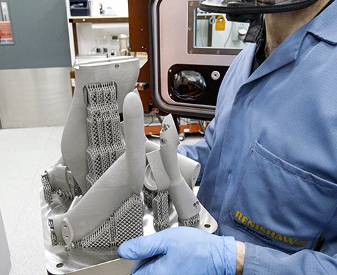

  • Prototype handlebar components after removal from a Renishaw RenAM 500Q additive manufacturing system

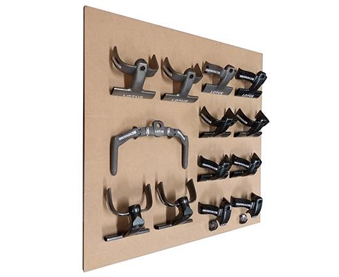

  • 3D printed titanium and aluminium handlebar components (image courtesy of Lotus Engineering)

Renishaw initially used its AM expertise to rapidly produce plastic and metal prototype parts to undertake aerodynamic testing of the new design and ensure that parts were light, geometrically correct and strong enough to endure the strain from riders. After proof of concept, the company then used its own RenAM 500Q AM systems to additively manufacture aluminium and titanium parts, including handlebars, for the competition bikes, with parts customised for individual athletes.
