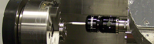

Renishaw looked at the original process and recommended a visit to Renishaw's demonstration centre, after which Martin Aerospace had a high-accuracy MP700 touch probe fitted to the twin chuck mill-turn machine producing the part. The probe is used to measure the finished size of several features, with the operator using the printed results to update machining offsets.

After each component has been machined critical features are inspected with the Renishaw MP700 touch probe, with measured values recorded by CNC Reporter. These values are plotted on an SPC (Statistical Process Control) chart and used to constantly adjust the process.
Grooves that take seal rings are coated and then ground with driven tooling on the mill-turn machine to within 4 tenths of a thou, an incredibly tight tolerance. This tolerance is now achieved reliably under the watchful eye of the CNC Reporter software.
