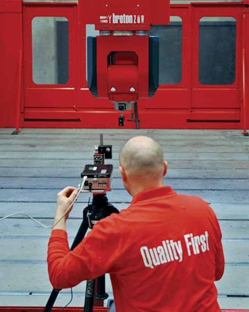

Once a machine is assembled, a XL-80 laser calibration system is used to test the positioning, linearity and the angular errors of the machine tool. These controls are carried out on all the machine tools produced by Breton. This process is also performed annually on all in-house production machinery and repeated on the rare occasion that deviations are recorded. The company opted for the XL-80 system after experiencing difficulties using other systems on axes over four metres, a problem which is non-existent with the XL-80.

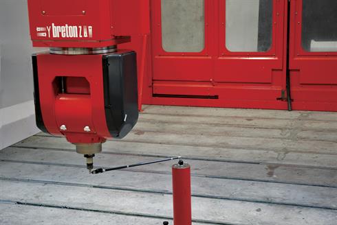

Machine axes are also the subject of strict quality control routines facilitated by using a Renishaw QC20-W ballbar system. The QC20-W is used to quantify the squareness between each linear axis and to check a machine tool's fundamental positioning performance via a quick check.
Breton uses the Renishaw QC20-W ballbar to check machine positioning performance
Once staff in the maintenance division, who already used a ballbar system for their periodic checks, showed others how easy to use and accurate the system was, it became a standard tool in every part of the company needing calibration controls.
Among other things, this check is also the first one conducted when customers request technical support for machines installed in the field. At Breton's 40,000 m2 premises, checking the three linear axes of in-house production machining centres is also a straightforward operational routine. In just 20 minutes the operator can check the condition of the machine and prevent possible manufacturing errors. The ballbar system is now used internally to calibrate the production machines and externally for technical support, particularly when a customer suffers a machine collision.
Breton employee using XL-80 laser interferometer
