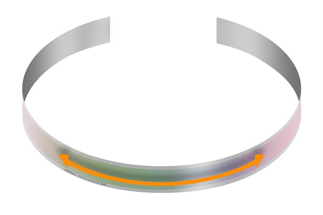

Measuring a partial arc rotation by wrapping the scale around drums, shafts or arcs.

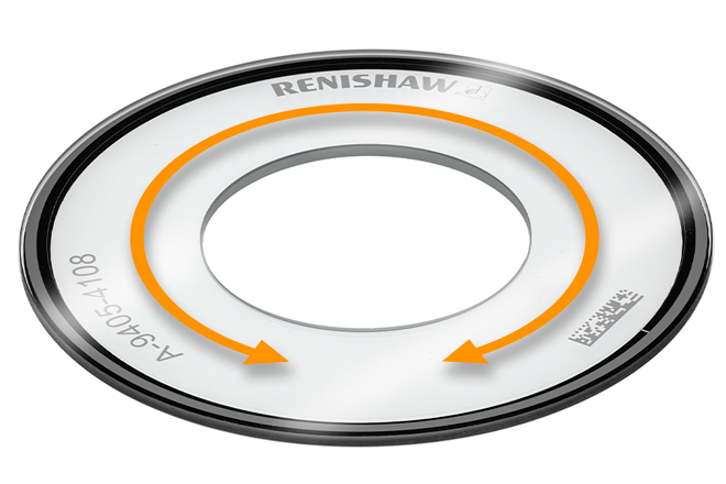

For angular position measurement and the motion control of rotating elements.We were impressed by the capabilities of the RESOLUTE UHV encoder system, it fully meets our requirements including robust mechanical design, suitability for high-temperature bake-outs and resistance to radiation ageing. Renishaw's encoder really does the job.

A rotary open optical encoder consists of a position measurement readhead and an accurate rotary scale marked either on the periphery of a ring or on the face of a disc.
The readhead measures position by optically sensing the regularly-spaced scale markings. It then outputs this information as an analogue or digital signal.
The signal is subsequently converted into a position reading by a digital readout (DRO) or motion controller.
