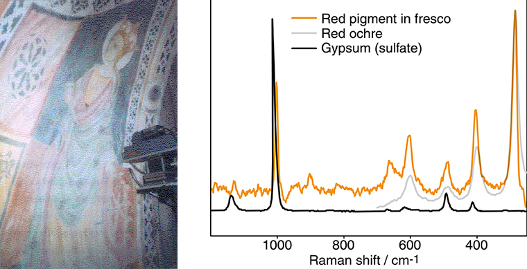

- analyse pigments and lacquers used in paintings, frescos, murals, and tapestries

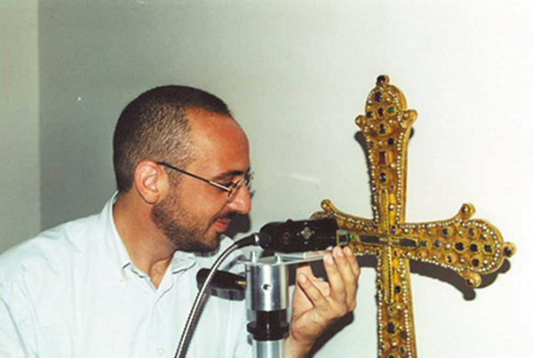

- investigate gemstones and minerals from cultural artefacts

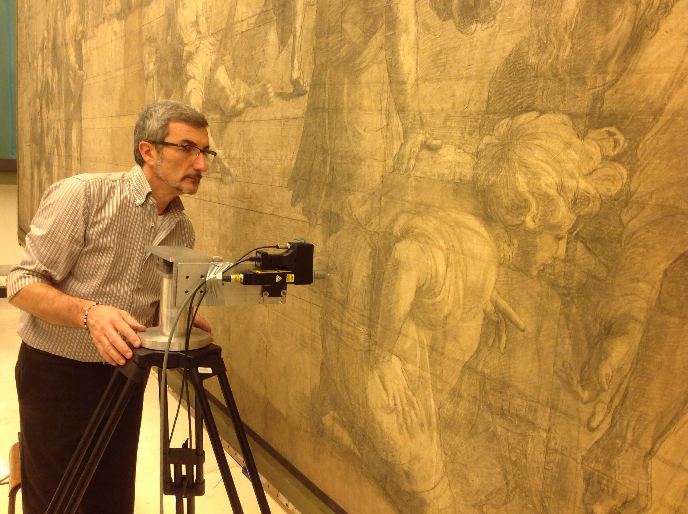

Raman analysis is non-contacting and non-destructive, so you preserve your entire sample. You can take measurements in situ so there is no need to remove fragments for analysis.

Use Renishaw's spectral databases to help you to identify pigments clearly and unambiguously. You can get started on analysis immediately, without having to create your own database; just add your own specific spectra later.

If moving your sample to a laboratory is impossible or impractical, we have a solution. Take Raman analysis capability to your sample and perform detailed in situ analysis though fibre optic probes.
